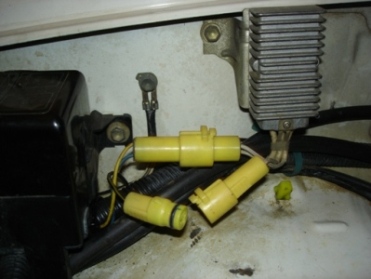

IT"S ALL FIXED.
RUNS GREAT !!
I was poken and pulling on all wires and for some reason ( I did not do)
The resistor Yellow Plug on passenger fender was NOT SNAPPED IN
I would post picture , but the Kb and size is to small
