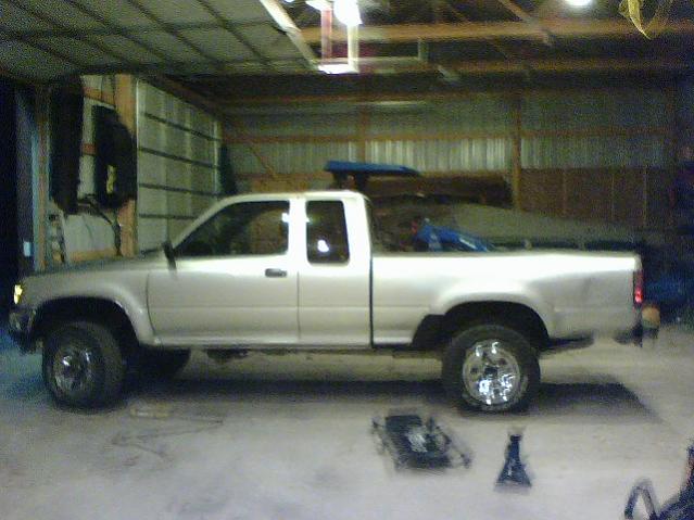

pic

31x10.50x15s will fit stock and look nice.
Like these both on 31s.

not very big but ill work on that. probably post updated pics tommorow or something

that is one clean lookin yota,
