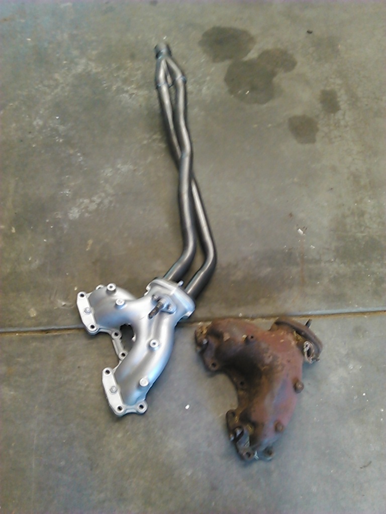

Here is another style of the pipe. I don't know if it goes to a 2 or 4 wheel drive or a change that Toyota made during a year change. You will see the one you have and the one I have in the picture on the 22 motor. It may even be the difference for a carb or EFI motor.
I don't know if it makes a difference but in my mind this pipe would be better for air flow but no way to test it. Anyways, just another pipe to make you aware of.
A side by side comparison of the difference in "Y"/downpipe.
