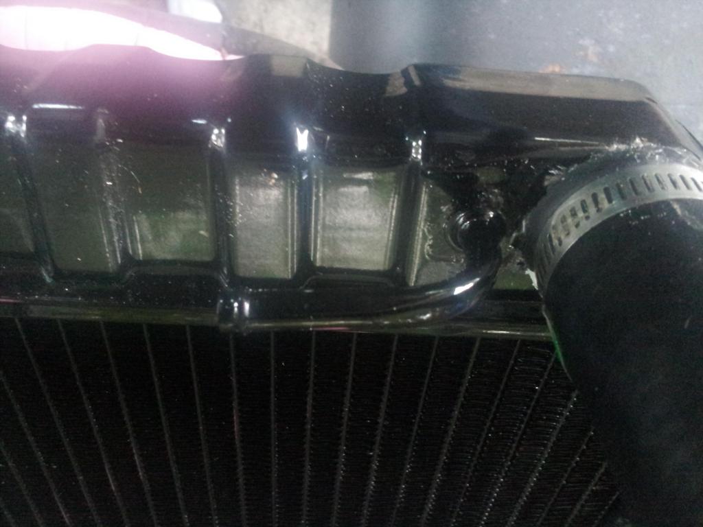

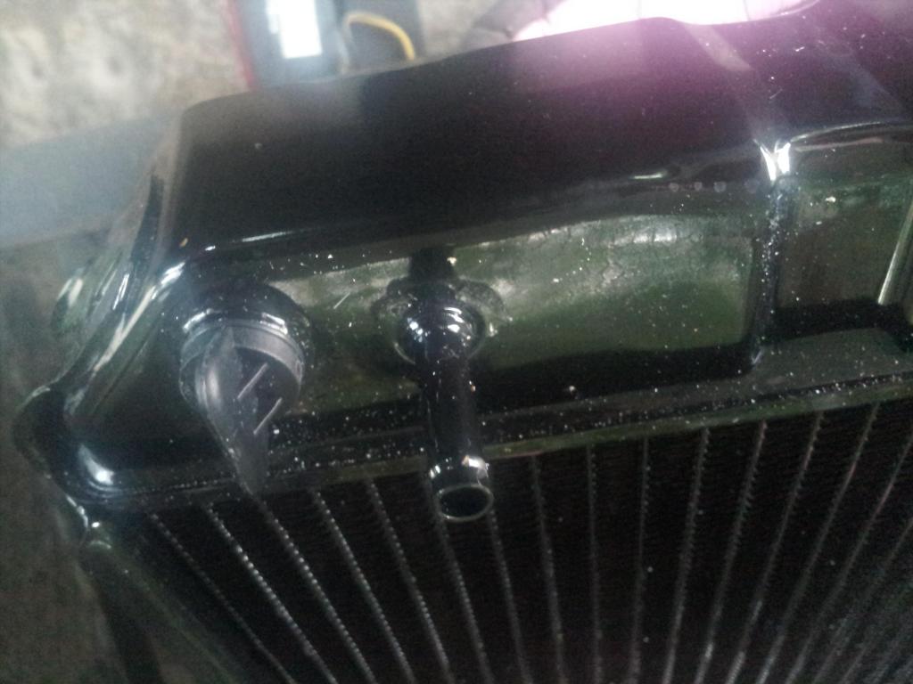

Hi bought a new CSF2314 Radiator - 3-row, Metal core, Metal tank and it looks impressive. I noticed two small pipes coming from the bottom of the radiator that I have nothing to hook to. One beside the lower hose and one beside the drain plug. I ran water through it and it did not leak out of them. Do I have to cap them off or just leave them alone? What are they for?

I think those are tranny cooler lines. Do you have a manual?

They're transmission cooling lines. Otherwise, unused because your truck is a manual. don't worry, transmission fluid simply passes through there to keep cool from the radiator. So no, your radiator will not leak fluid.
This is just how most radiator companies make radiators nowadays. saves on costs on making either or.

With a manual, I'd connect those two tranny coolers ports together with a piece of hose so if the interface between the tranny cooler and main rad fails you don't lose your coolant.

heh. as clever as that sounds, the automatic transmission cooler attachment really does nothing for a manual. it wont lose coolant if you don't plug them. its literally there so that transmission fluid can PASS through into the radiator and "cool off" from the radiator fluid around it.
No harm no foul from plugging or not plugging them.

You could plug them simply to prevent any dirt or debris from entering but it doesn't really matter. It will never leak unless it's a junk radiator. Most radiators have those nipples for auto tranny coolers.

When I replaced my radiator last year on my 93 4x4, the radiator came with plugs installed and the transmission spigots loose if I needed to use them. If your radiator came with the plugs, I would plug them so stuff don't crawl in the openings. Either way though no harm in leaving them unplugged as the previous poster mentioned.
