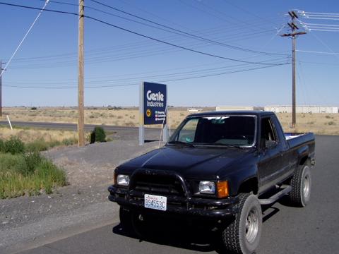

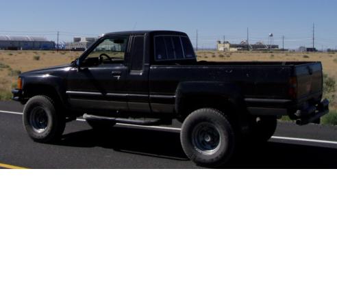

Attached Thumbnails what is more important, clutch, or-toyota-new-1988-truck.jpg   what is more important, clutch, or-4x4-black-toyota-b.b.safe.jpg   what is more important, clutch, or-p72800454.jpg
