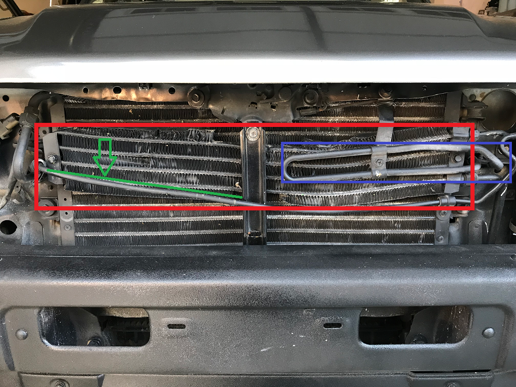

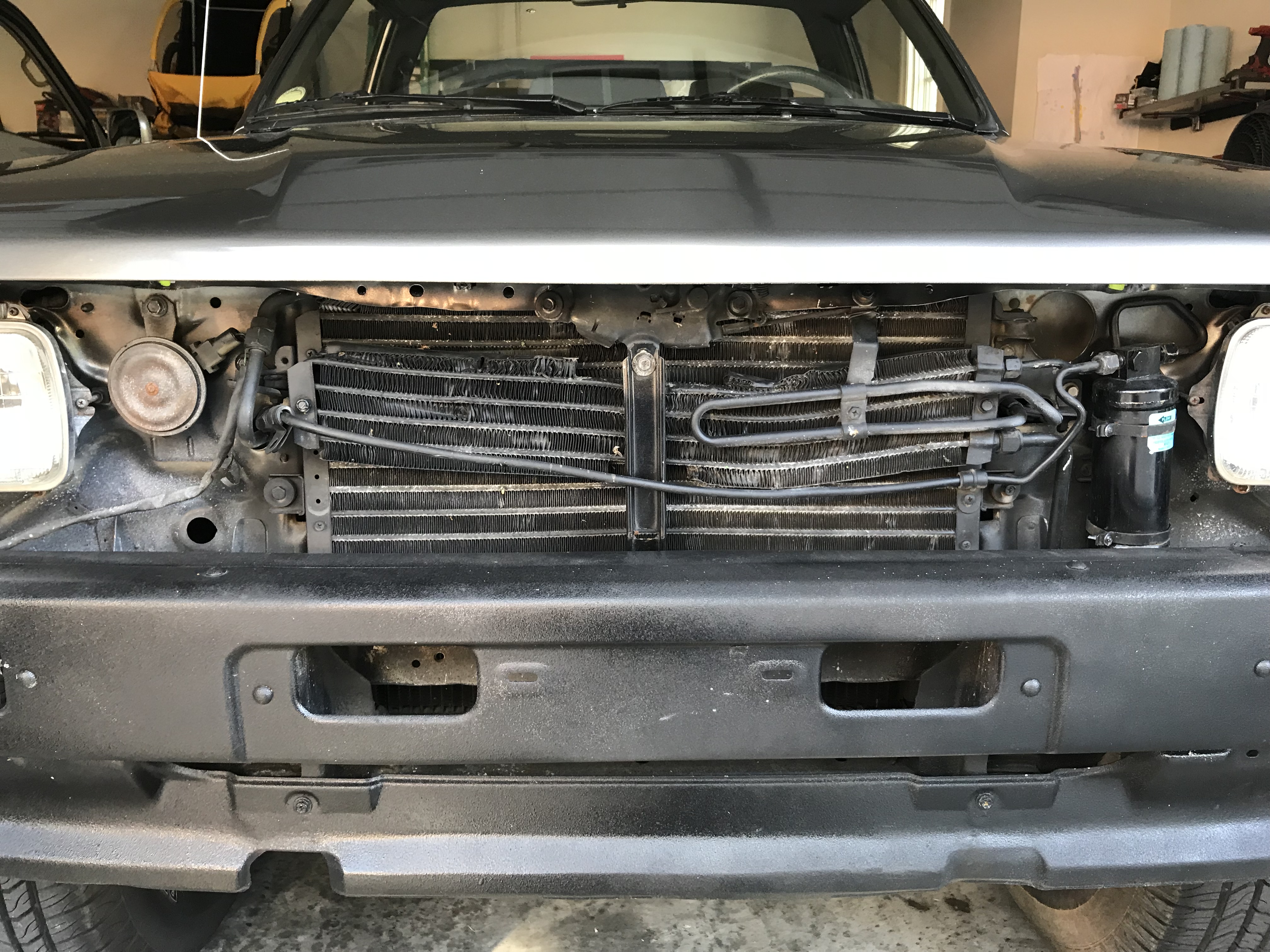

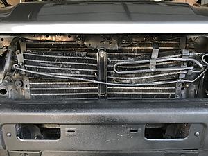

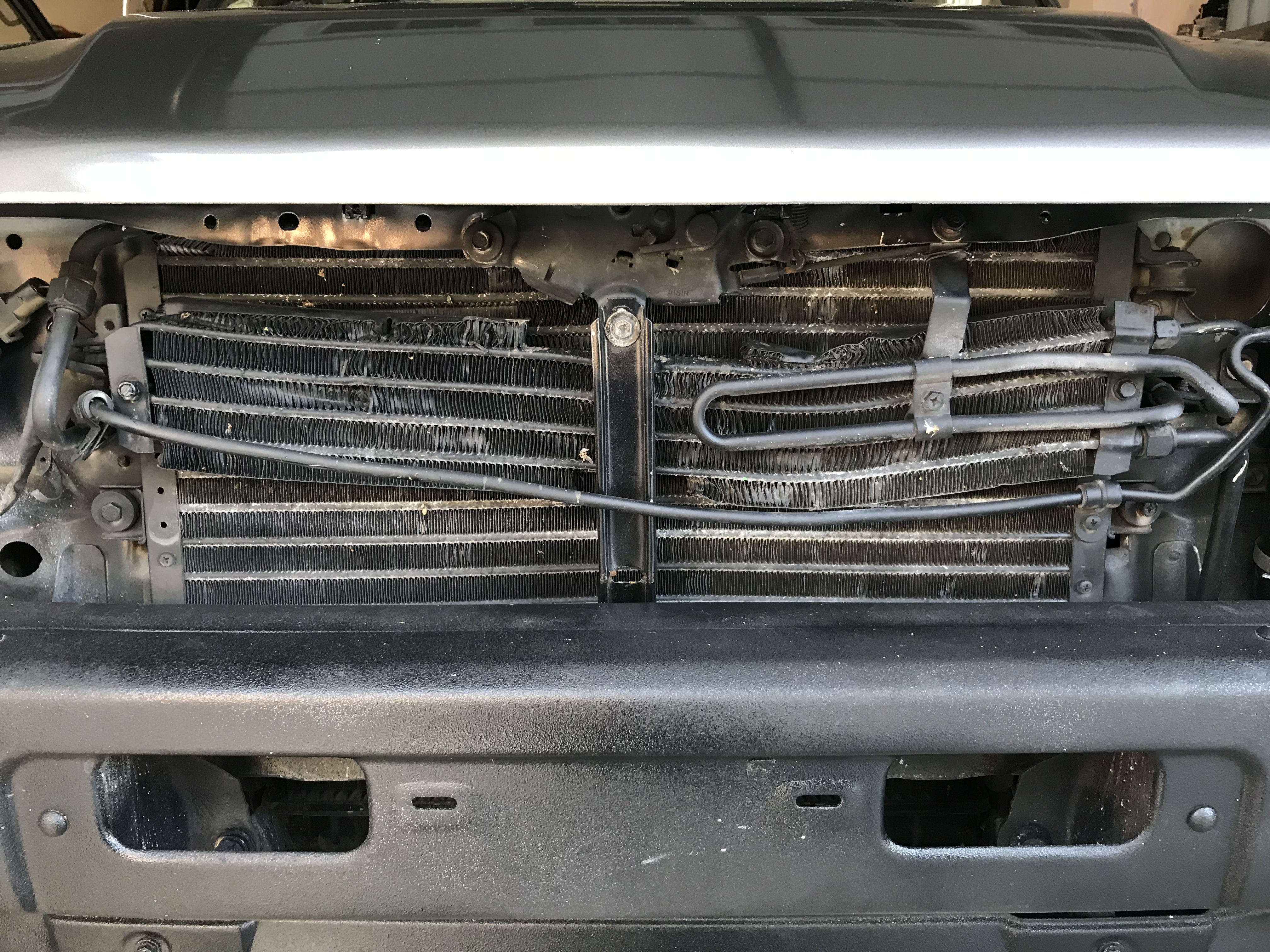

This may be a dumb question, but I this cooler in front of the radiator allows the refrigerant in the A/C system to cool the air before it reaches the radiator. The lines run through the A/C dryer, so I know refrigerant is in there. It’s on a ‘87 22RTE. See pics.
It looks like a PO intentionally cut sections out of it. Does this need to be replaced? If so, with what?
A/C system seems to work fine. Radiator is ok, but I have a new one coming from Amazon since this one is so old. I did have to replace the thermostat recently due to overheating which cause boiling - hince the replacement radiator.

you have a brass and copper radiator
If that radiator is brass/copper I would have it rodded out and reuse it. Those are the bomb! The new aluminum and plastic jobs are ... (I am old school though).
It looks like part of the condenser lines have come apart somehow on your A/C system. Look up a condenser for your truck and see where they went before getting loose. Keep in mind if you disconnect the A/C system anywhere you should vacuum it out before reassembly. (note this is not with a shop vacuum).
Upon a further look, It may be an auto trans cooler or power steering cooler, it may still be part of the A/C condenser. Trace the lines to whatever they connect to

I'm not an A/C expert, but it looks like you have the stock (maybe) condensor, and in front of that another small (3 rows?) cooler. The additional cooler looks to be in sad shape, but if it's not leaking it may still be working. But I don't think it's part of the A/C system. Does the turbo need some sort of cooler?

Looks like the PO hacked the condenser lines to me. The A/C works fine. I have a vacuum and manifold gauges, but would rather not have to refill the A/C system if not necessary. May try to straighten them out a little and leave it as is.

I hope this helps:

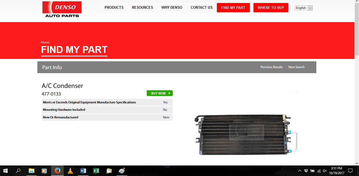

The "three row radiator" (Boxed in RED) in front of the condenser is actually part of the condenser and is stock OEM on some 4Runners and I guess turbo trucks too. It was an "expansion" to the main condenser behind the three row section to help dissipate more heat and improve interior cooling.
Denso (Original Equipment Manufacturer) still makes these: https://www.partsgeek.com/catalog/19...condenser.html
The "U" shaped lines boxed in blue in the first picture is the power steering cooler.
The line with the green arrow pointing to it is for the A/C.
It appears the condenser is still working, but is in pretty sad shape. If it was my truck, I would replace it at some point.
