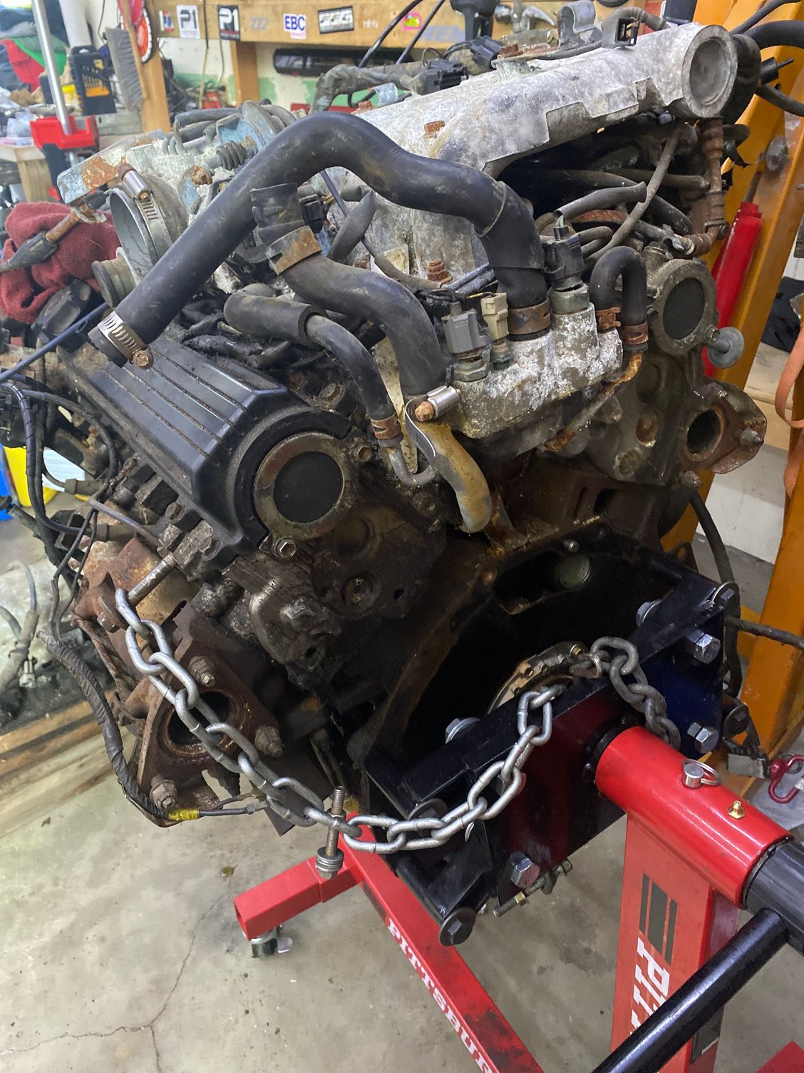

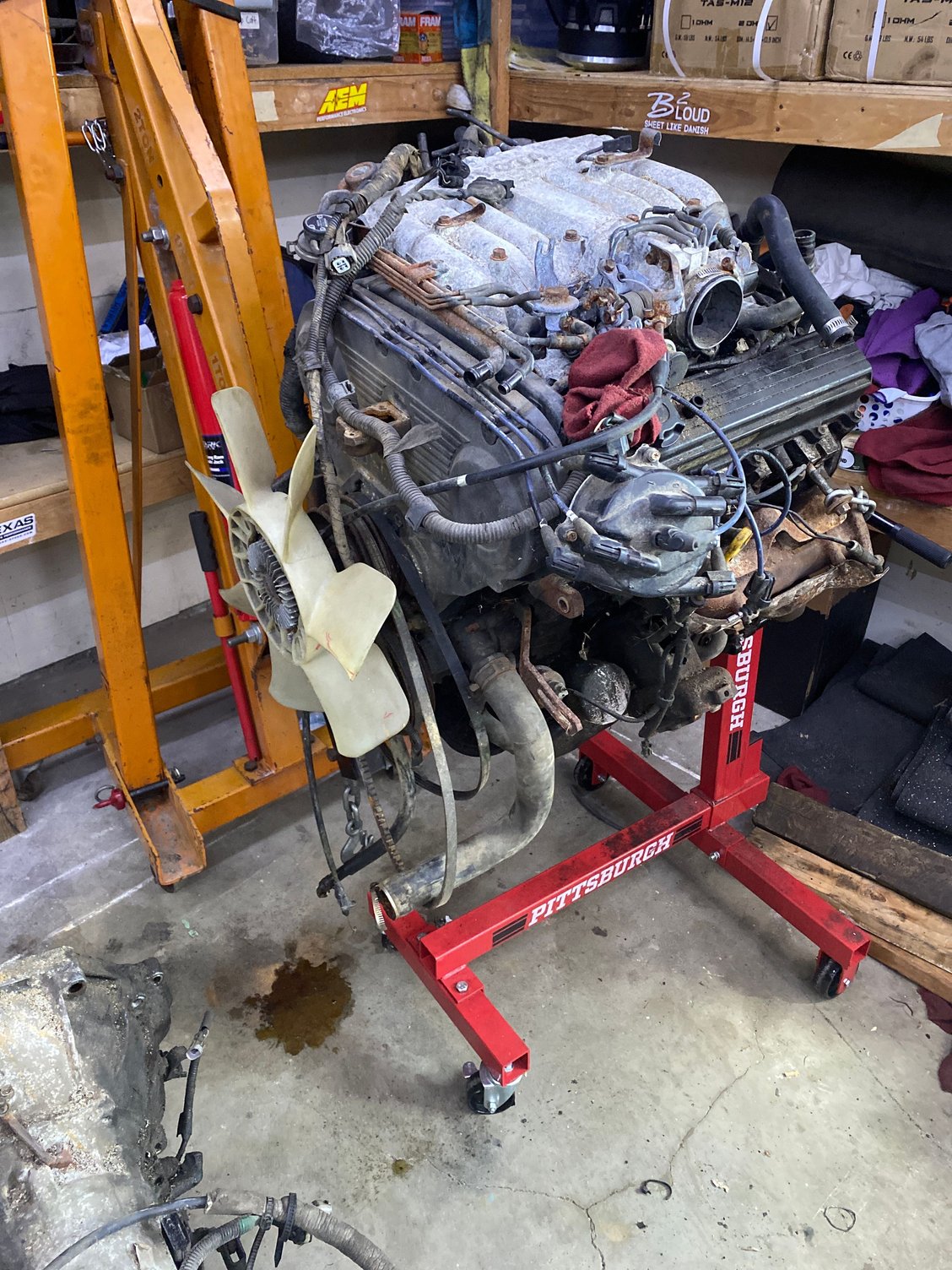

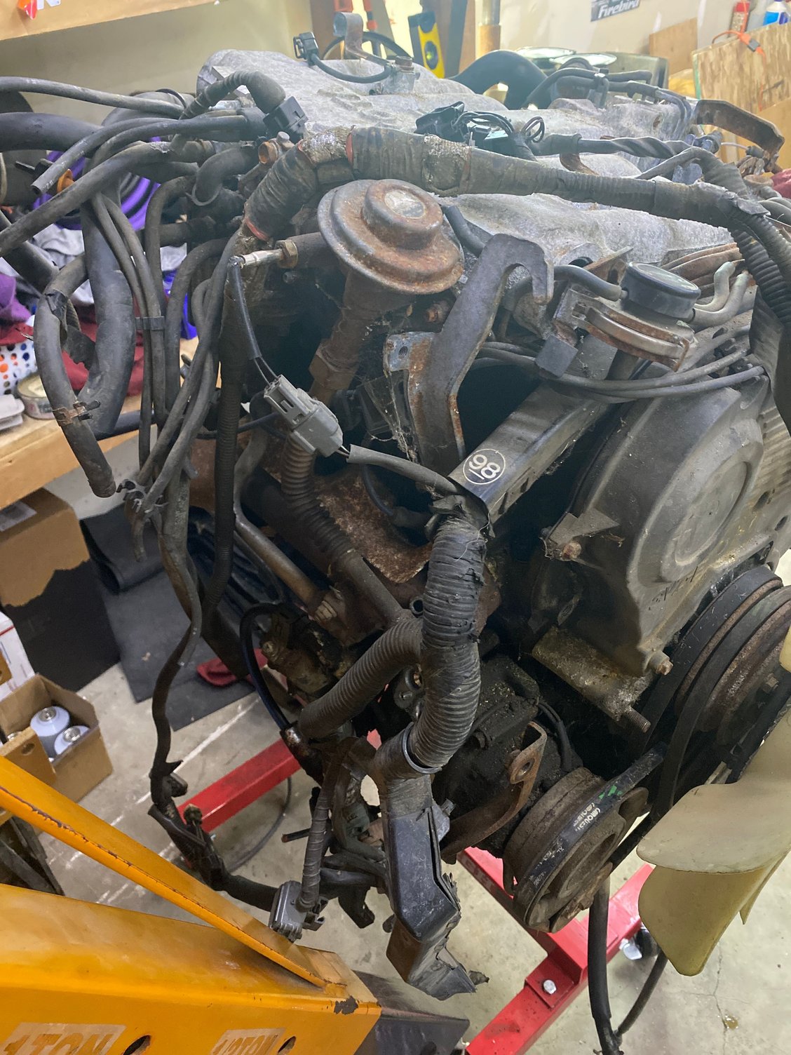

I have just pulled my 3vze with a blown head gasket and got another 3vze with only 85,000 miles on it from a neighbor. I have the newer engine on a stand and am wondering, what do I replace now or at least
inspect or adjust before I throw it in the rig? Same with the transmission , I have both of them sitting here and do not know which one I should use. This will be a daily driver. I have already decided to delete the exhaust crossover during the process as well.1995 4Runner
