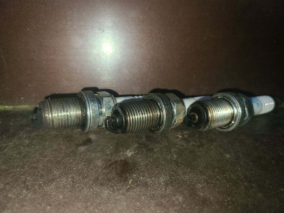

180k isn’t a spring chicken either. I would start by pulling the spark plugs and seeing if any are oil fouled. If it’s burning oil the plugs will show it.

Spark plugs tell a lot.
you can’t do a compression test, but it is feasible to do a leak down, which actually is more informative. You just need the tool and a compressor. It would give you an idea on the rings, valves, and head gasket.

Posts: 17
Originally Posted by dbittle
After some thinking about it, how far does the truck need to be driven to burn a quart of oil, and what weight oil are you using?
it's eating a quart about every 200 miles. it also fouled up spark plugs after 3000 miles of driving at the most. it's pretty bad. i'm using 5 weight, i know heavier weights supposedly burn slower but I was using 10 for a while and didn't notice the difference.
i asked the guy with the engine to pull the plugs, he only pulled the drivers side but they looked fouled to me. i'm no expert, but there's clearly oil on those, right?

Wow. I would have to agree. I really thought that would help. Jimkola recommended a leak down test. That’s a good next step. Maybe the valve guides are shot and it’s coming in there.
