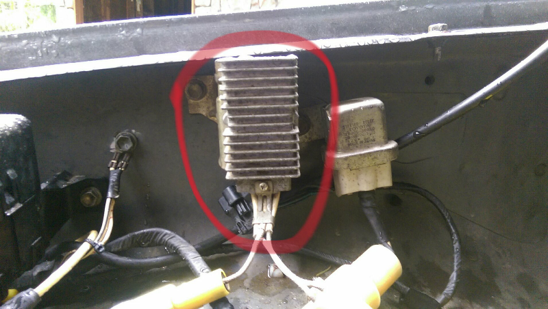

What is this item? The p/n is not complete any longer and I can't find any info on it.

On my 88 truck the part number is 28515-26030, its the EFI resistor solenoid.

Looks like the injector resistor.

Yep. I had the first set of numbers minus the last digit. The second set was completely gone. After some digging I found the complete p/n. I had a positive line touch it yesterday and saw a spark. I won't have the head back on till tomorrow to find out if it's still good or not. Fingers crossed, seems to be a pricey part new.

Found one on EBay for 12 bucks

The one on EBay has the same p/n as the one listed for the 88. Didn't 88 have a different impedance than any other year? I have an 86 and the p/n on mine should end as 26033. The seller states it will work for all 22re motors.

This site http://www.toyotapartsoverstock.com/...851526030.html says 28515-26030 fits both years (look under 'fitment')

Thank you very much. Good to know
