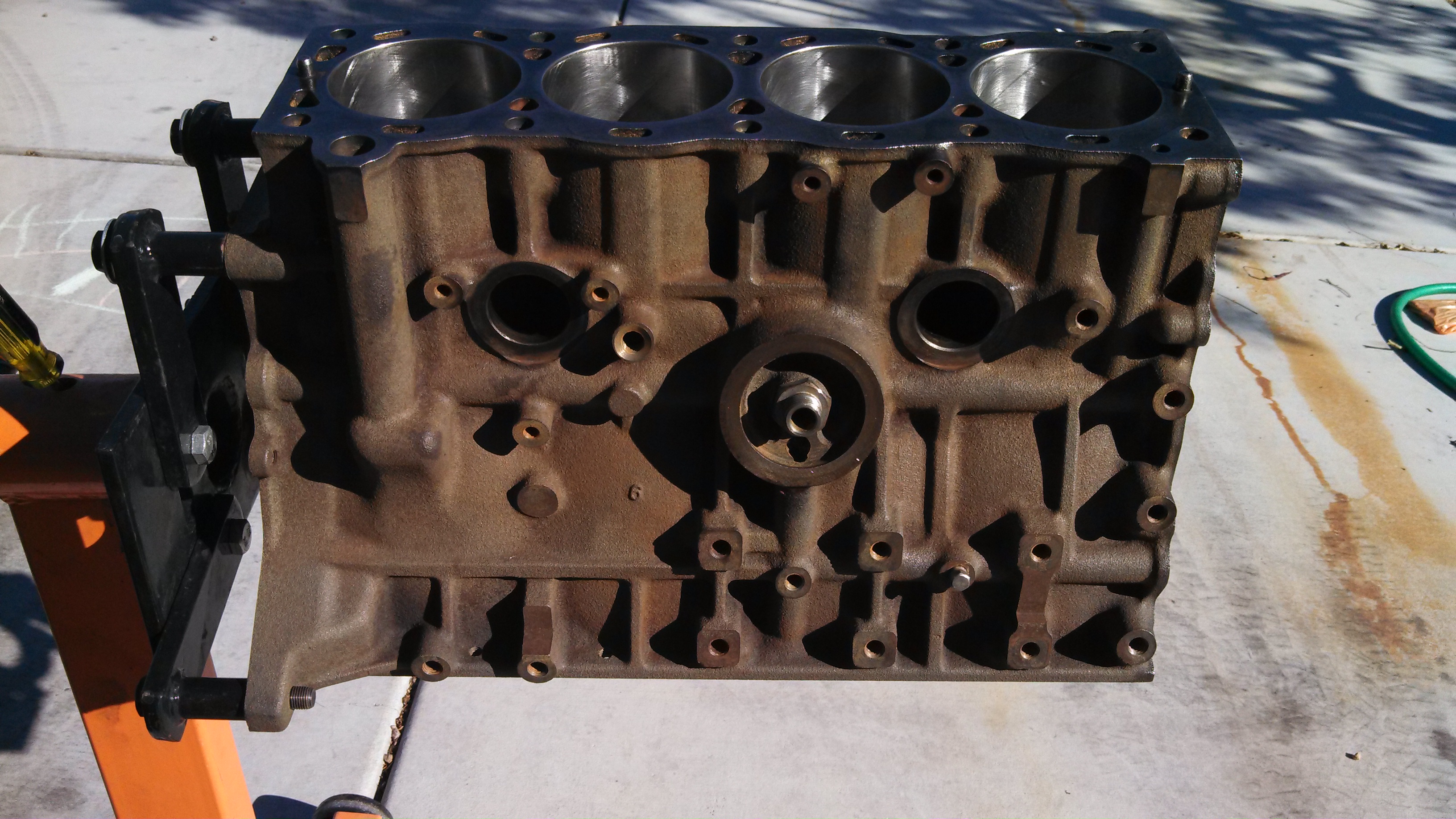

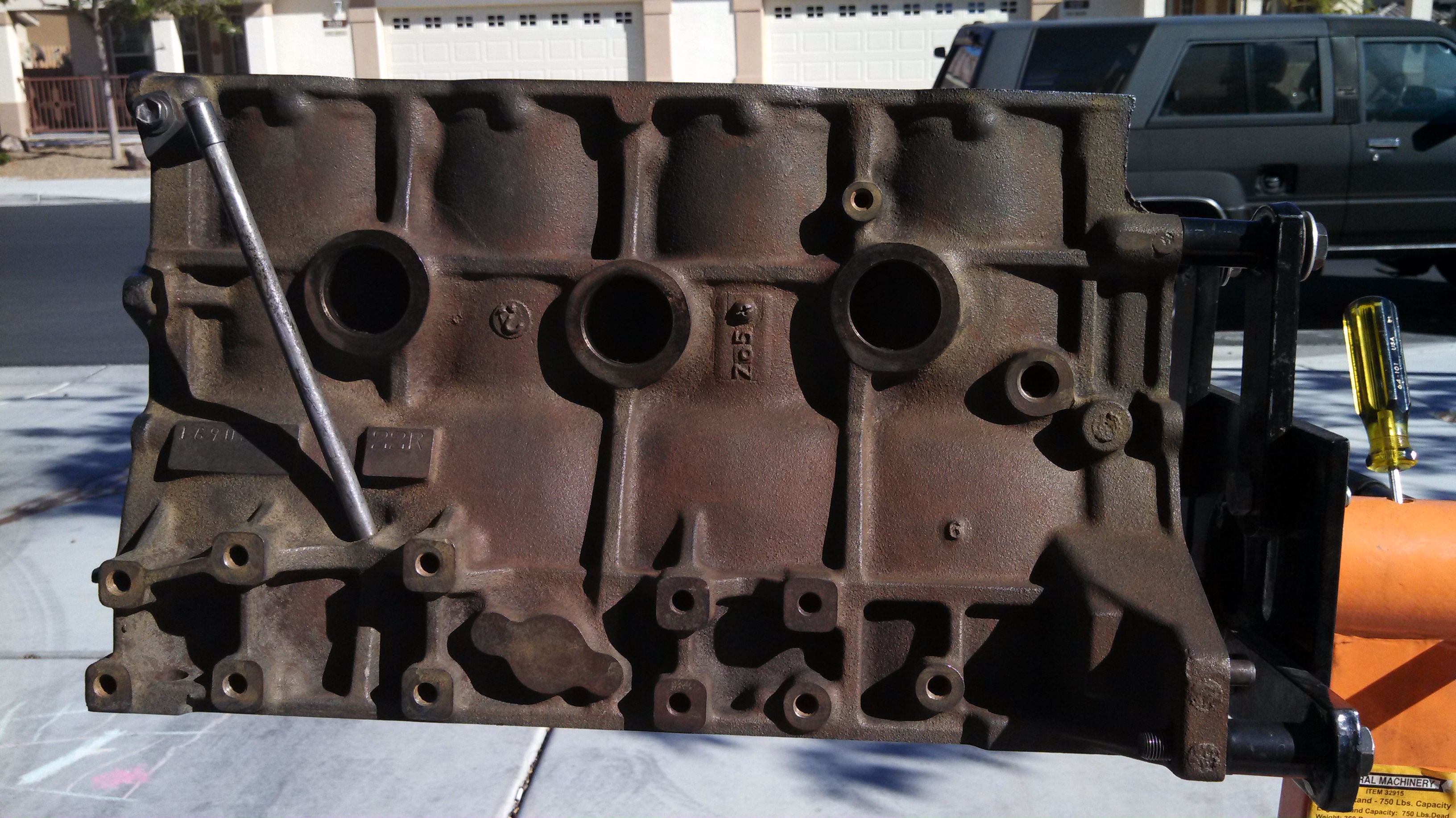

what 22r year block is this?
I have a block I don't know what year it is to know what specs to build. It has a serial number but not a vin. It is marked 22R. Any way to get a date range? Thanks.

Looks like my 83 -84 motor

85-95 laser block its got the saturn (first pic behind/below the dipstick)

Looks like a 1985-1995 block to me. This should also help: http://www.22reperformance.com/22RE_...ification.html

Definitely post 85 block. Has the "Saturn" which is the boss for the oil for 22ret
