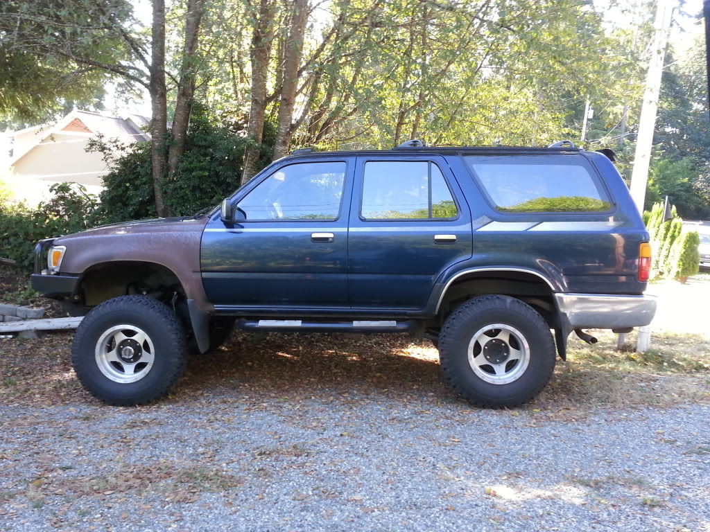

I found some fenders on CL that were on a parts for sale rig and were the same color as my 4runner and went to try and talk the guy into selling them, instead I came home with another 4Runner now I have 3. My girl wasn't very happy but she'll get over it soon enough.
When I got there to check it out I couldn't believe my eyes... a near perfect, 2nd owner '93 T4R with engine problems and I was customer #1. I couldn't let it slip through my fingers so I offered up what I thought was a reasonable price for the whole thing and he took it.
I brought it home and washed it and the body and paint are perfect. It has been well taken care of. Total pavement pounder, probably never been on anything more than gravel roads. Other than the engine it only needs a windshield and a new power antennae. Has the usual hole in the drivers seat, i'm starting to think that's how they came from the factory. Leather seats and door panels in good shape for 20 yrs old, power everything and it all works, nice Pioneer system, good tires, factory jack, owners manual, etc.
The one thing I don't really like other than the 3.0 is the automatic transmission. At 214,000 miles what are the chances this thing will last through another motor? Can any of you guys running automatics tell me the pros and or cons of these? I've had too many toyotas to remember but never had an automatic.

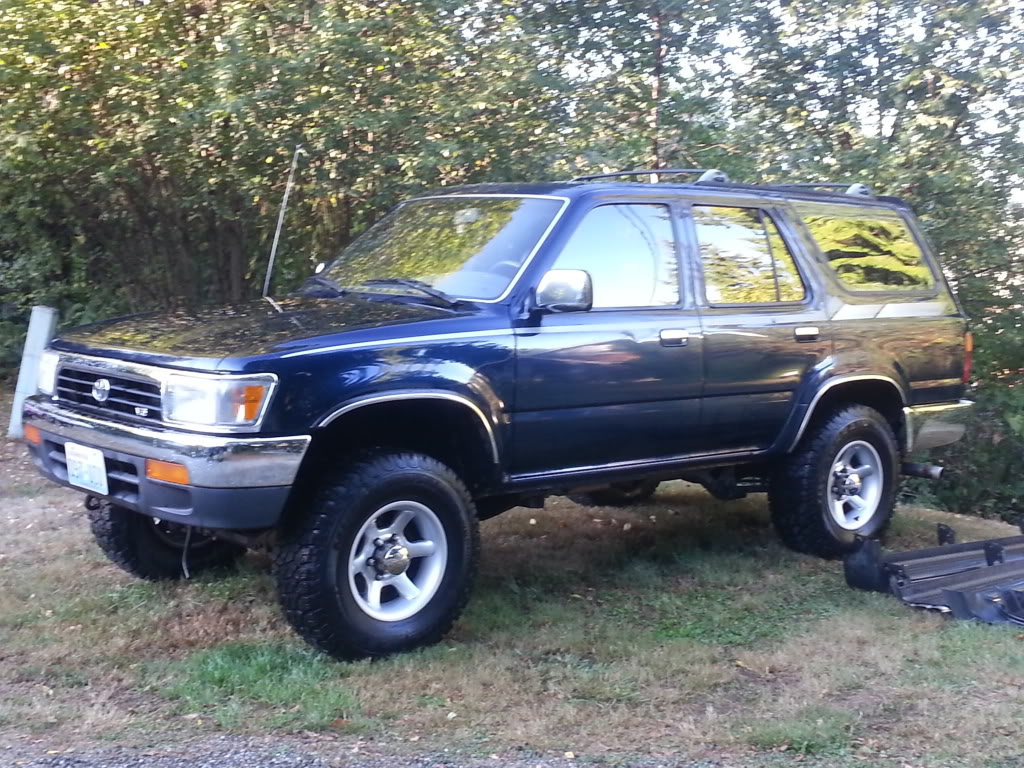

Wow, that sounds pretty complete... so it should be good to go from the sounds of it. I will be replacing the radiator for sure and i'll do the flush/fill/flush/fill too. Hopefully it will hold up for 100,000 miles but i'm ready to do a tranny too if it's necessary. I'll probably give it to my daughter who lives out of state so major repairs will be difficult for me and impossible for her. I just want to give her a reliable rig that we don't have to mess with.
It's actually nicer than first thought and nicer than my current 4 Runner, I had thoughts of keeping it and giving her mine (which is still pretty nice but not perfect). Although I have so much time and money into mine I should just keep it, it's sweet but this one is even sweeter.
I bought cars for my other kids but she always wanted to make her own way and pay her own bills, now I want her to experience the wonderful world of no car payments so I think this one is hers.
