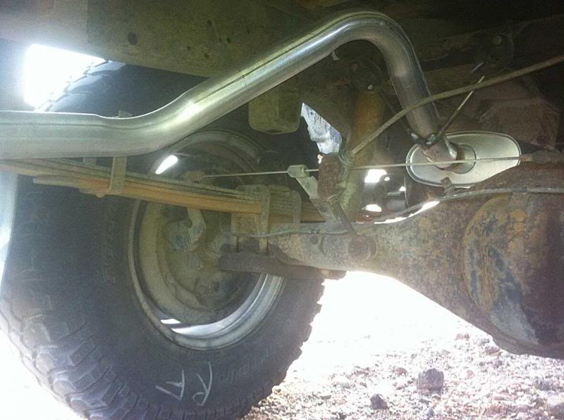

I have the "saggy butt" syndrome:
These leafs are pretty well flattened out; my kidneys hurt just looking at this picture. Right now, frame-to-leaf clearance is 7.5"; the left bumpstop is about 1-1.5" from the frame bumpstop; the right side doesnt even have a bumpstop on the spring.
