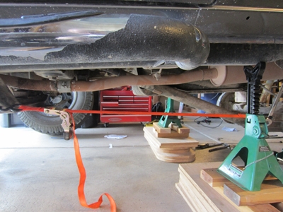

I left the truck hanging about a foot and a half out of the garage to give me extra room to work because this was only going to take a few hours and then I was going to take my wife to the drive-in... or so I thought.
So along the way I came up with this little idea. I am sure some of you have used it before, for those who haven't maybe it will come in handy when breaking loose hard to get to bolts.
Anyways so right after my proud moment of what I thought was a great idea, I discovered there was no way I was getting those bolts out. I gave up after a while of trying to figure out and feeling defeated. Then I had to figure out how to get it back all the way in my garage without completely reassembling it. I ended up having a buddy come over, we put floorjacks under the u bolt brackets and pushed the truck back. It took us a good bit to figure out how exactly to do this, would have been nice to have a Hi-Lift.
So tips and lessons learned.
Don't disassemble everything in a place that isn't ok to leave it if you dont finish as quickly as expected.
A Cargo strap makes for one hell of a nice breaker in tight space.

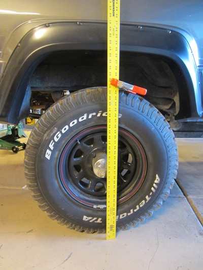

Before: 36.5"

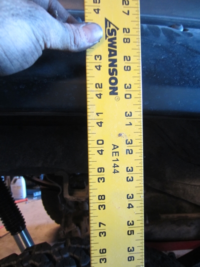

After: 41.25" (It settled to 40.5" in the first 5 days)
So I netted about 4.75 inches. This is with the top off and I am sure they will settle a bit. Skyjacker advertises that you get 4 inches from these on a 4 runner, 6 on a pickup.

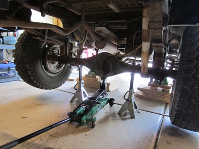

This is what she looks like underneath now.
Day 2 takeaway notes. When you install the TR60S springs they will not reach the shackles. My solution for this was to bolt the front and then I put the min the hangers with the hangers fully forward. After that I cargo strapped to my tow hitch and in front of rear spring eye then pulled the hanger into place. once you apply the weight on the vehicle, torque it down and it will stay in place just fine! Also dont forget the longer brake hose and bushings for your shackle to shackle mount hanger. I got just the ones with the springs, didn't even think about the ones on top! They are at Autozone you just need one box to do both side as there are four which is not listed on their site.
