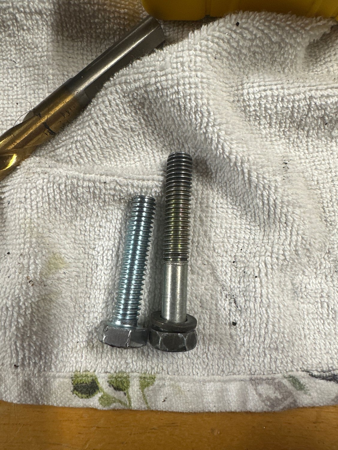

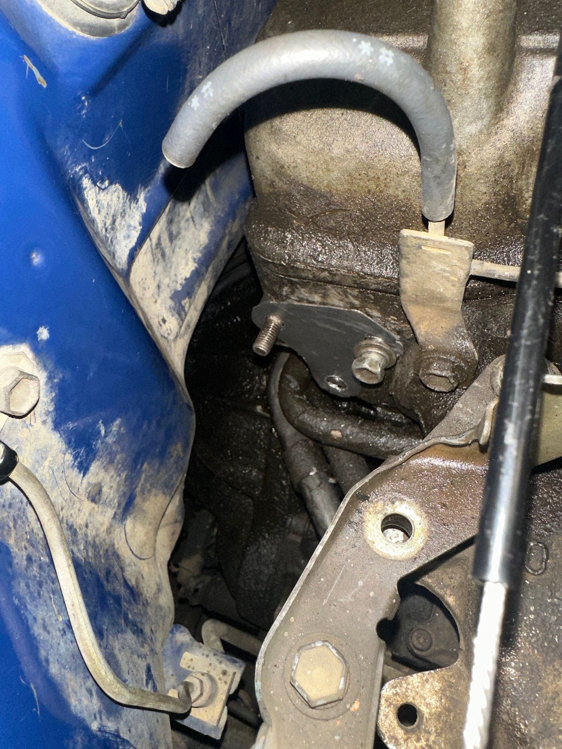

Third, I’ve tried to fabricate a block plate for the EGR valve since it seems like the smart thing to do is delete it entirely, and the kit only comes with a block plate for the manifold where the EGR pipe bolts on. Having trouble bolting the plate on but I made it using a random piece of sheet metal from ace and an angle grinder, and we had to replace the bottom bolt with a shorter one that is threaded the entire way as the EGR valve sticks out from the block and needs a longer bolt than what we took out from it. I just want to know if I am going about this the best way without buying the actual plate kit online and waiting for it to ship. Just wanna get my truck running again and don’t want to pay a mechanic because I’m stubborn and I want to learn how to be self sufficient. Thanks in advance to whoever’s willing to help for your time.
Original bolt for EGR valve next to the replacement bolt for the block off plate (which doesn’t want to thread in)
Plate we made

First question: You do not need to buy a filter to for the top of the valve cover. I have the stock PCV Valve there and run the hose to the bottom plate of the air cleaner with the fitting that came with the kit. Second question: I deleted EVERYTHING regarding emissions including the Charcoal Canister. I also installed a vented gas cap. Third question: I did exactly what you did for the EGR Block Off Plate. The stud you are referring to can be removed and replaced with a bolt or just run a nut and lock washer down on it to secure the plate.
