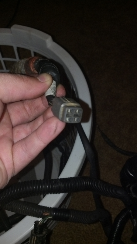

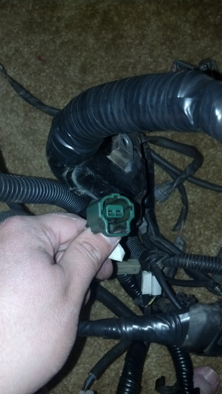

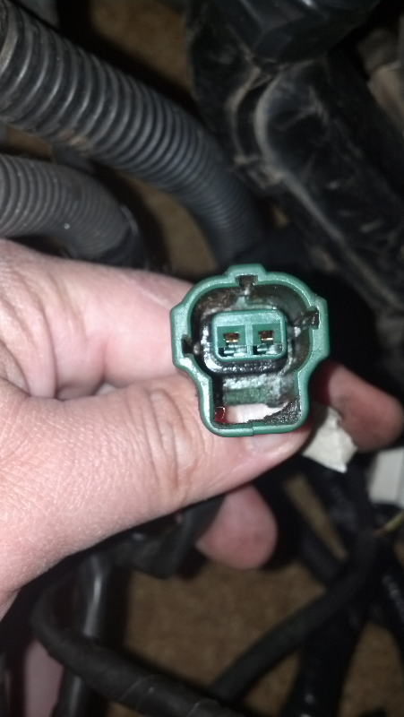

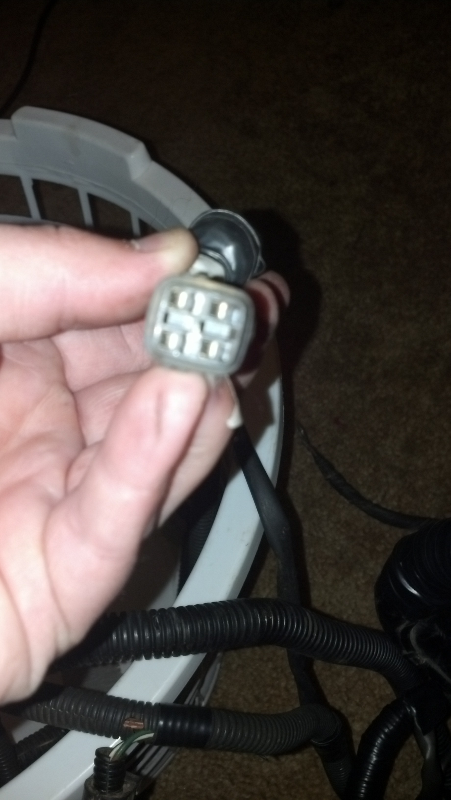

Here is what I need to get off
Attached Thumbnails way to fix plug ins on wiring harness-forumrunner_20130804_224752.png   way to fix plug ins on wiring harness-forumrunner_20130804_224804.png   way to fix plug ins on wiring harness-forumrunner_20130804_224817.png   way to fix plug ins on wiring harness-forumrunner_20130804_224831.png
Old 08-04-2013, 07:05 PM
BigHoss_27's Avatar
Join Date: Jul 2013
Posts: 194
Received 0 Likes on 0 Posts
And I don't see how to do it
