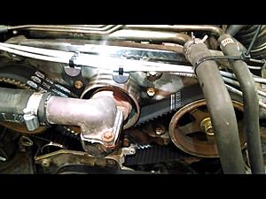

That's for thermostat .
im talkin about water outlet pipe
top front w 2 Bolts

​​​​​​​that's pic off the net
