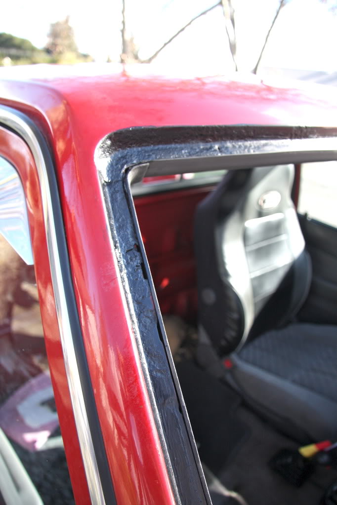

Leaks cause of this.

Get rid of the windshield trim. It's notorious for trapping dirt and water underneath and rusting out the pillars. I removed mine and filled the gap with black roofing calk. Problem solved.

No one has mentioned that the leak could be coming from under the cowl as well. Three body panels come together and are only sealed from the factory, but there is a high spot that holds water and doesn't drain down the inner fender. Eventually this will rust through and the water runs down on your floor. This is what mine looked like before I repaired it.
This is what it looked like after!
