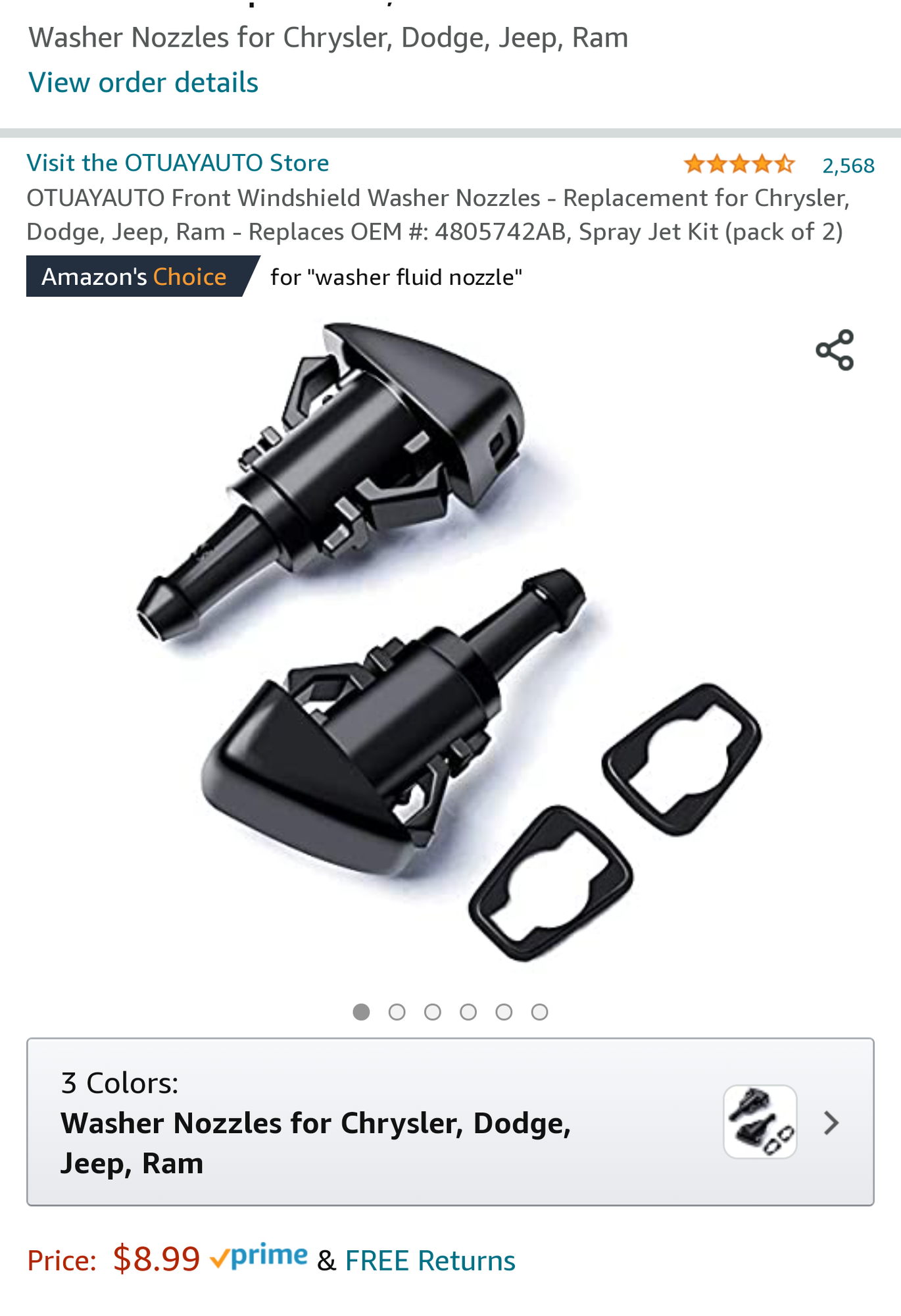

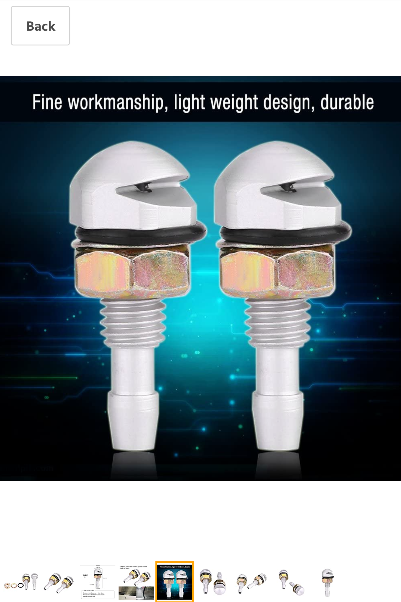

I've tried these from Amazon and one other that was just too big for the hole in the hood. The set pictured that are threaded fit but they're of such poor quality. The hole thru the middle was the same diameter as the fluid hose so it had no pressure pushing out. Auto zone sells Dorman universal nozzles, but I've been told by the managers that they get returned immediately. For this reason I didn't risk my $20-$30. The one that looked like it would fit was also a single sprayer.
I was hoping to find another vehicle that uses one of the same hood hole size or similar enough to make work. A known good universal would be great too.
