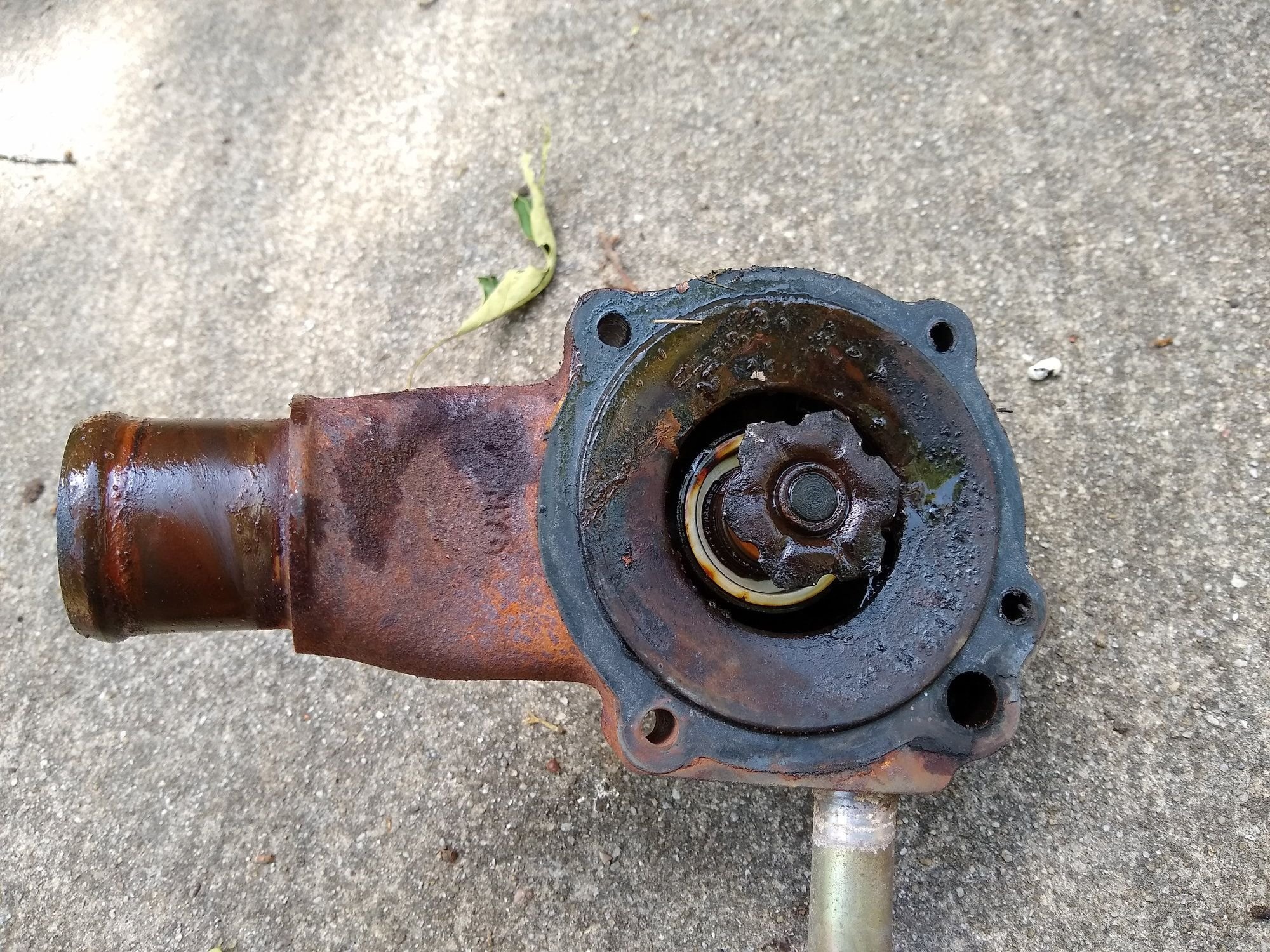

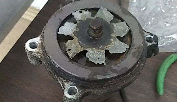

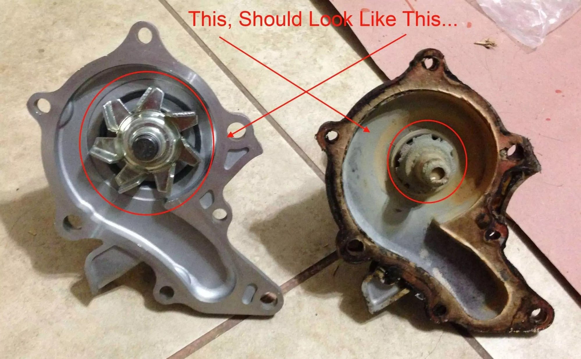

no, a radiator pressure test is looking for leaks, it's not a pump test... the pump should have a weep hole in the casting, underneath the shaft, if it's leaking you definitely need to replace the pump.
beyond that, i've read that the impeller in the pump can get rusty and erode, which would lower efficiency and send junk into the system, but i've never experienced that... coolant also lubricates the water pump bearing? replacing the pump might be a good idea.

water pump impeller corrosion:

I’ve only seen one Toyota waterpump where the impellers eroded away. And I’ve seen some pretty horrible cooling systems over the years.

a possible explanation for those corroded water pump impellers:
"Electrolysis is the likely culprit when "fail again so soon" is for real, and new heater cores/radiators quickly start leaking. Electrolysis eats away metal in the cooling system and the relatively thin walls of heater cores and radiators are the first to fail. There are two primary causes for electrolysis; acidic coolant and bad grounds. An inexpensive multimeter can be used to diagnose both."
