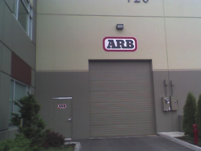

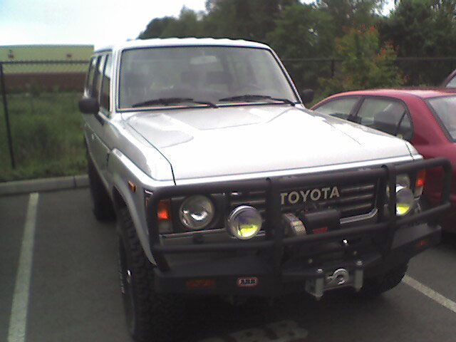

Well this week has turned out to be great, thanks to Dudebud in Carnation, Washington. The story starts with picking up my 2nd gen ARB torsion bars at the Renton Warehouse and while there I got a good look inside the place. The guys from Arb (thanks Seth and Chris!) took me on a tour and gave me keychains, stickers and catalogues from Oz. I spoke with some of the techs and got good advice on local installs (highly recommended in Washington for 4runner ARB air locker and other ARB installs were Jason at Eastside Custom in Kirkland, and Robbie at 4wheelparts in Lynnwood). Seeing as these recommendations came directly from some of the guys at ARB I will definitely keep these in mind. In the parking lot as always were some sick ARB equipped vehicles and I am attaching some photos. The Land Cruiser in particular was absolutely pristine both interior and exterior, and I could see the air locker actuators inside. Full OME suspension and bullbar/winch on BFG A/Ts.

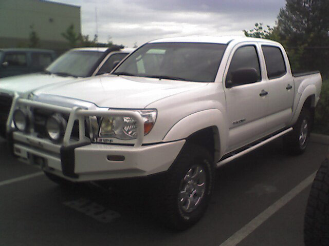

The Tacoma was similarly equipped.

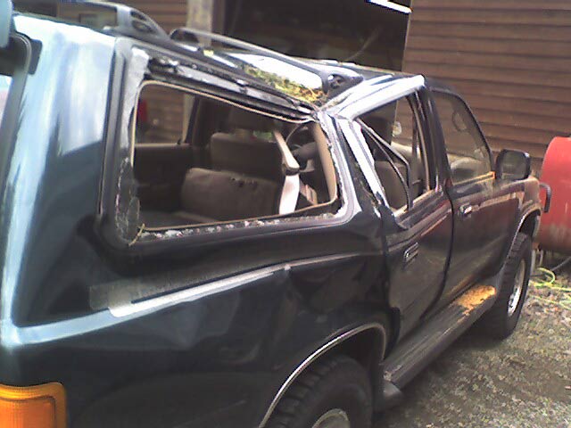

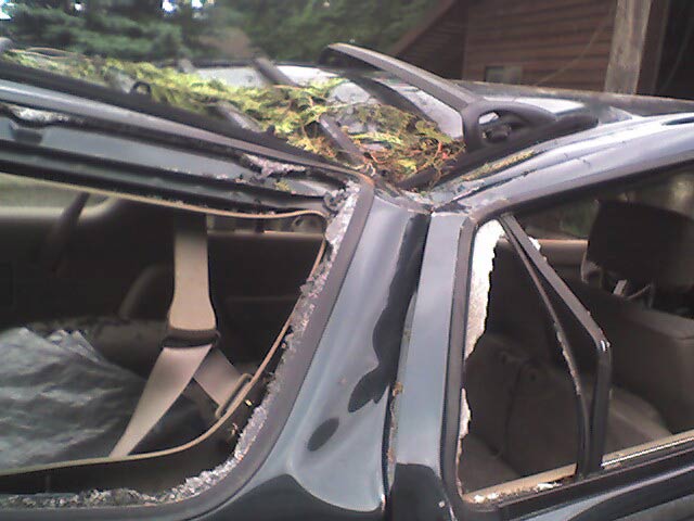

before he got started we went to pick up a client's 4runner which had been crushed under a tree. arriving there, the vehicle wouldn't start, and luckily I had my christmas present Xantrex Powerpack HD600 in the back, which I have been using for camping lately to run radios and ricecookers http://www.xantrex.com/web/id/182/p/1/pt/29/product.asp The 4runner started up and Dudebud drove it back to his place, it was in BAD SHAPE!
luckily the engine was still running but the entire rear cabin is destroyed. Dudebud will replace the entire body on this runner, an impressive feat.

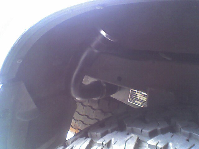

returning to the shop we determined that with the 2"sdori rear spacers that my OME shocks would be overextended. we decided not to put them on, but frank at sdori can machine these down to 1" which would be perfect. dudebud then proceeded to install the extended range gas tank (11.5 gallons) which mounts below the spare tire. This took a long time to install as the fit was not exact and some drilling was required, also the primary gas tank had to be emptied completely and new gas lines and filters had to be routed. I had bought the master install kit from NWMP and it worked out great. Dudebud did a masterful job. the fill neck is in the rear passenger wheel well well out of the way and I have since filled it up and there is NO LEAK. it hides under the spare tire perfectly and when full I can feel a more stable ride, I really recommend this tank and combined with the main 17.5 gallons there's almost 30 gal for extended trips. http://www.nwmp.com/search.asp

fwiw... that 4Runner belongs to a friend of mine.
"Thank You Dan".

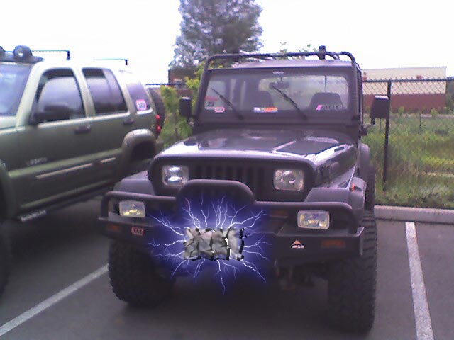

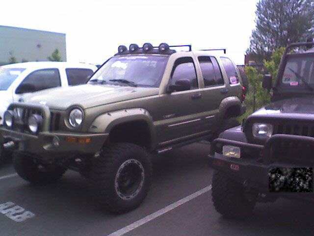

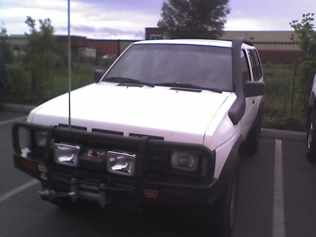

3more pics...not sure what kind of vehicles these all are but some nice mods. sorry got creative on the photoshopping

The green SUV Jeep had a tent on top of it they were test fitting when I was down there a few weeks back.
I beleive that is Chris's (office) Jeep.

jeep liberty, right?

Looks like that other non-jeep is an older Pathfinder
