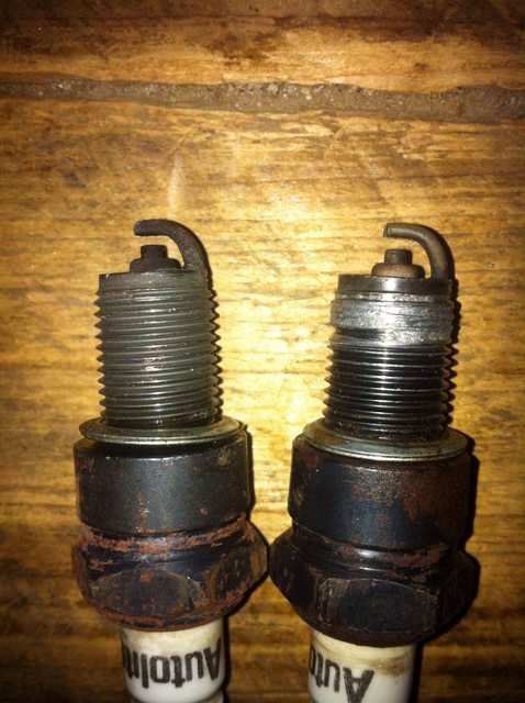

Problem solved!
I was waiting on my fuel filter to come in, and to borrow a breaker bar to get my wheels off so I decided to do the long overdue tuneup that I had the parts for:
Replaced the air filter, plugs, wires, cap and rotor. Plugs 2, 3, and 4 came out easy, but plug #1 required WAY TOO MUCH force. By the time I got it out, with the help of PB Blaster and a 1/2" wrench, I figured I'd have to retap the spark plug hole. Anyways -- here's what my plugs looked like:
Video: Does this seem like fuel starvation?-mhi5hl.jpg
Plug #1 is on the right. Bought this truck 15k ago, should have tuned it up right away. The rotor was pretty bad, too.
Anyways -- truck started right up after all the new parts went in! Even though the spark plugs were awful, and all had different gaps, the truck still ran decent before. Not sure why it just randomly died one day after running at least 15,000 miles like this. Lesson learned either way.
Thanks for everyones suggestions and help!
