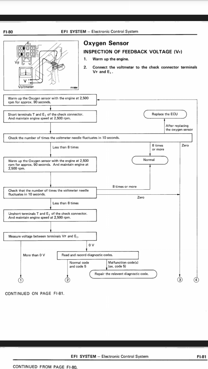

Ox sensor feedback voltage, from 88 fsm
The 88 manual has these two pages on the subject.

So I ran 2 wires into the cab, one ground and one connected to Vf, and connected them to an analog voltmeter. I pulled the EFI fuse for a while and went for a drive. Here's what I got once it warmed up.
While driving in closed loop the voltage would oscillate between .1 and .9 volts
With T and E1 connected I held the rpm at 2500 and got 10-12 oscillations in 10 seconds.
I pulled the jumper out and got a voltage right around .900V.
Here are my answers to the questions I posted earlier (correct me if I'm wrong);
So what is the correct way to measure Vf, idling or engine off? (Directions in the link above indicate T and E1 disconnected, run the engine and measure. They don’t specify running or not)
Why is it fluctuating at idle?
What is my actual Vf reading?
Measure Vf with engine idling
It was fluctuating at idle because it was in closed loop and acting normally
My actual Vf reading is 1V which is ~1.25v (they said that the voltages can be off of the specific numbers)
Additionally, based on my results; the O2 sensor is good. My Vf value is on the rich side of normal (engine is adjusting the fuel down by 4-10%) but the ECU can handle it.
