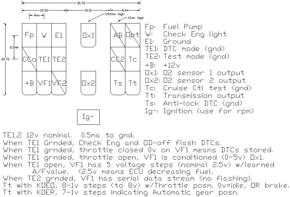

For years '93-95, this diagram describes the function of the pins on the diag connector under various conditions.

Vf signal from ecu, at the bottom with its cover on

Thanks for your reply CO_94_PU, that pic is really helpful. Just to be sure I understand the procedures. To read stored A/F value I would warm the engine up, leave TE1 open and connect Vf in the connector pictured to bare metal. To read the O2 sensor I'd warm up engine, ground TE1 run the engine at 2500 rpm and connect O2 to Vf. I'd look for the O2 to cycle at least 8 times in 10 seconds (per FSM).
Some additional questions
1. So if I wanted to set up a narrow band A/F gauge I'd need to run a wire from Vf to the gauge and run a ground wire from the gauge to ground, correct?
2. I know that TE1 is in the 2 connector round plug but I'm not sure which one it is (Green--yellow or brown), does anyone know? I guess I could just guess and check, its a 50/50 shot.
3. Lastly, does anyone know which wire is what in the 3 plug connector? Would this be in the electrical diagram? I do not have a copy of the electrical diagrams, just what is in the FSM. I'd love something like the image RJR posted for the early 22RE.

No. Do not directly ground any ECU output ever, just a bad idea in general.. You measure the voltage between VF and ground to find out which range the learned trim is set to .
VF is an output not a bidirectional port, only ever connect a volt meter!
Not covered in the linked document. I'd expect it to fluctuate as described rich-lean-rich.
Thanks again,
Winky
1, to put a guage on there you need a second sensor, there is no breakout for the Ox signal in this era. In theory you could splice into the factory signal, but it will (depending on the guage impedance) have variable effect on the ECU readings.
2, this era uses T and E(e1) they are both in the two place plug seen above (with the SST wrapped around it)
3, not sure off hand what signal is on those three wires or the single wire.. Easy enough to measure connection at the ECU and reference the ECU pinout
