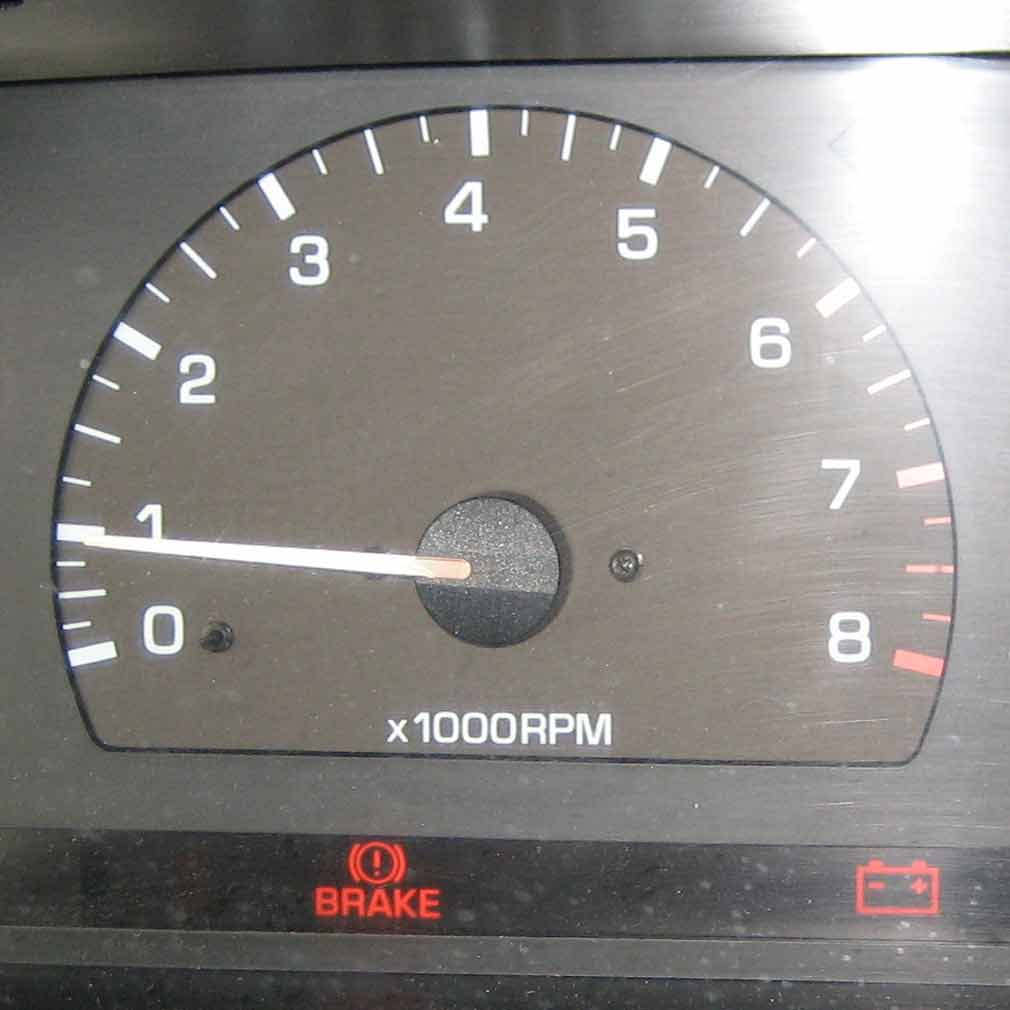

I'm headed out of town with the truck 22RE and the alternator is not charging (battery check light and brake light comes on) below 1500rpm and won't charged above 12V on the dash gauge at any RPM. I tightened the alternator belt and that seemed to solve the problem (at 6pm). I took the truck out 10pm and the problem was back again.

Below 1550 rpm, here is what the lights are doing:

Brushes.

You won't make it where your going on battery power alone. How do you know you are 'kinda' charging? The so-called volt meter in the instrument cluster is a joke and should not be used as a tool to diagnose alternator output and charging rates. If you are seeing 12 volts or less it is probably just the battery voltage itself. You should be charging at nearly 14v. Put a volt meter across the battery terminals to check (needs to be running). I would personally be more worried about my truck leaving me on the side of the road than worried about killing a battery. You can buy brushes cheap, but they will need to be soldered in.

It's the brushes... Replace them and take it to autozone or whoever and have them test it before re-installing it. If it still doesn't work, then your only out $10.

The brushes were worn down to a 1/4". Note: the springs are easy to loose. BUT, the brushes are the same for the 22RE and the 3.0L (3VZE) and they have the same springs. The springs and brushes were about $9.00, but you must factor in new coolant, as you have to remove one of the radiator hoses (power steering only) to unbolt the alternator.
