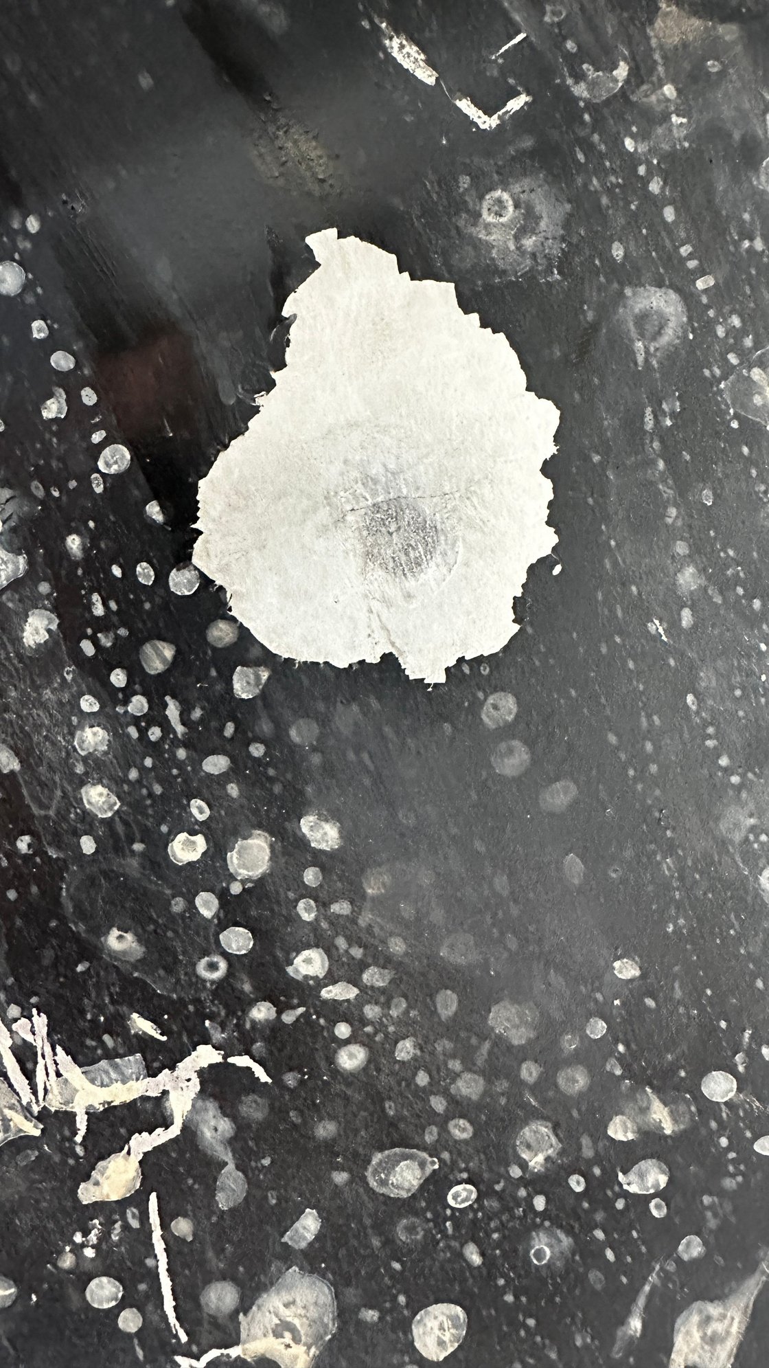

So as the title says I’ve have two fuel tanks give up the ghost in the past three months. Oem tank lasted 33 years, new spectra premium tank lasted three months. Cracked in nearly the same location, bottom of the tank where the weld around the drain plug is, and bottom of the tank where the fuel pick up baffle is spot welded to the bottom of the tank. You guys think this is a fluke? Just bad luck? My 4Runner is long travel and it is driven hard but it hasn’t really been beat on since I replaced the tank. Has maybe 60 dirt miles and most of those were smooth roads with the occasional hard hit. It’s basically stock except for upgraded diffs, suspension, and solid mounted drivetrain. I have a new tank waiting at the parts house cause spectra premium warrantees for three years. Just kinda stumped why this happened again. Also no, no rocks or logs have jumped up and punctured, it’s a crack.
any idea yotabros? This is weird and have never heard of this happening to anyone. Thought about rubber mounting the tank, kinda how a Dirtbike does it, but that’s just one more thing to worry about wearing out and failing when I’m miles and miles from civilization. Also would probably need longer bolts and to double nut them on the other side of the tack welded bolts on the frame.

rubberized under coating didn’t work very well, was crumbling off as I was working. It’s probably too cold or humid to dry, it’s 55° and raining out this morning. Anyway it’s in and has a few gallons in and the truck runs so I’m gonna say success so far. Still curious if anyone else has heard of this happening or has had this happen themselves. Super weird situation! Hopefully I don’t have to drop the tank again for a while.

Welp another spectra premium tank cracked on me, in the exact same spot as the last time. Once again covered under warrantee but I still have to spend an hour or so swapping them out. Lasted a little over a month. Kinda baffled, can’t really think of any reason other than my solid motor mounts are creating so much vibration it’s causing it to crack at its weakest point? I put solid motor mounts in around June of last year, by January I think the tank cracked, kept smelling fuel for a while but didn’t think much of it till I noticed drips around March, that’s when I swapped the first one, then again in June, now again this weekend. Nothing else on the truck has changed in that time frame other than motor mounts. Crawled around for about an hour last night and don’t see any cracks anywhere on the frame so it’s not being stressed that way. Kinda stumped.
