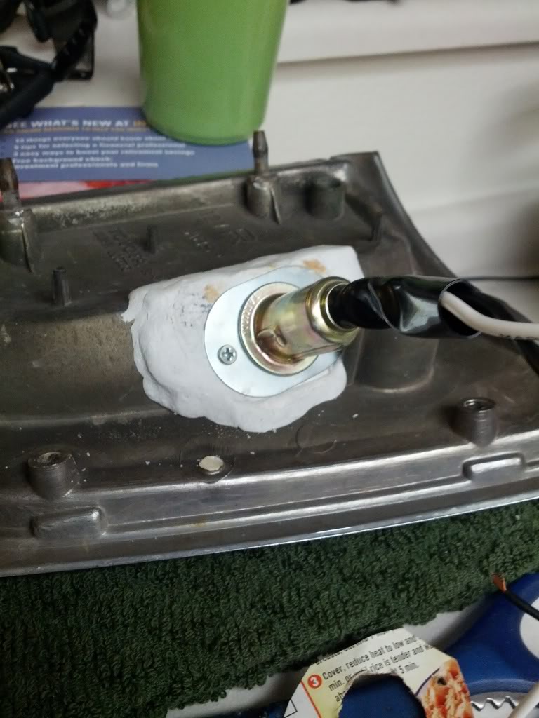

Just combine your turn signals with your parking light. Use an 1157 dual filament bulb and a dual socket for that bulb, enlarge the hole in your parking light, slap in the new socket, wire it all up and your golden.
this is the socket I used:
Dorman 84725 3-Wire Light Socket with Adapter Plate
found on amazon for around $6
The 1157 bulbs are very common and found at any local auto shop.
Use some kind of epoxy or jb weld plastic stuff you can drill to make a platform for the plate and socket. It is very easy and only take a couple hours depending on how you work.

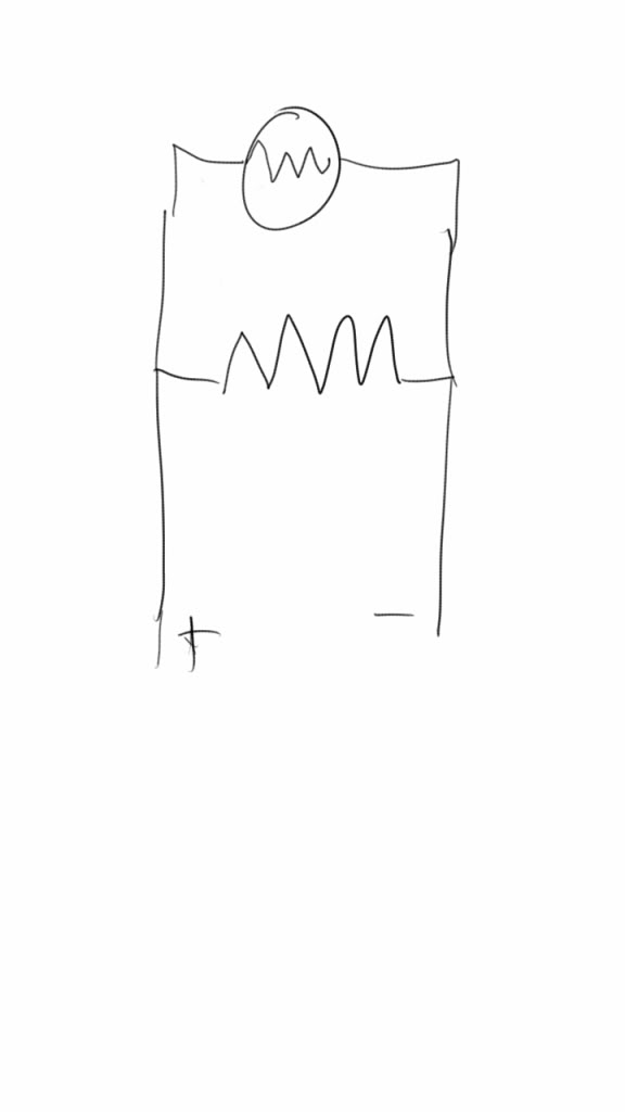

I don't think you guys are understanding the flashers I have right for turn signals are the trail gear one I posted those are on my bumper at the moment. What I'm trying to say here is where would. I put the resistor or whatever

Probably run a resistor in parallel, not sure on the resistance value though, find the resistance of your original bulb and use a little less than that. I still say combine the turn and parking light, it looks better and will be brighter as well. I ran the trail gear for a couple weeks before I decided to do it better.

You should be able to wire in a resistor like this
