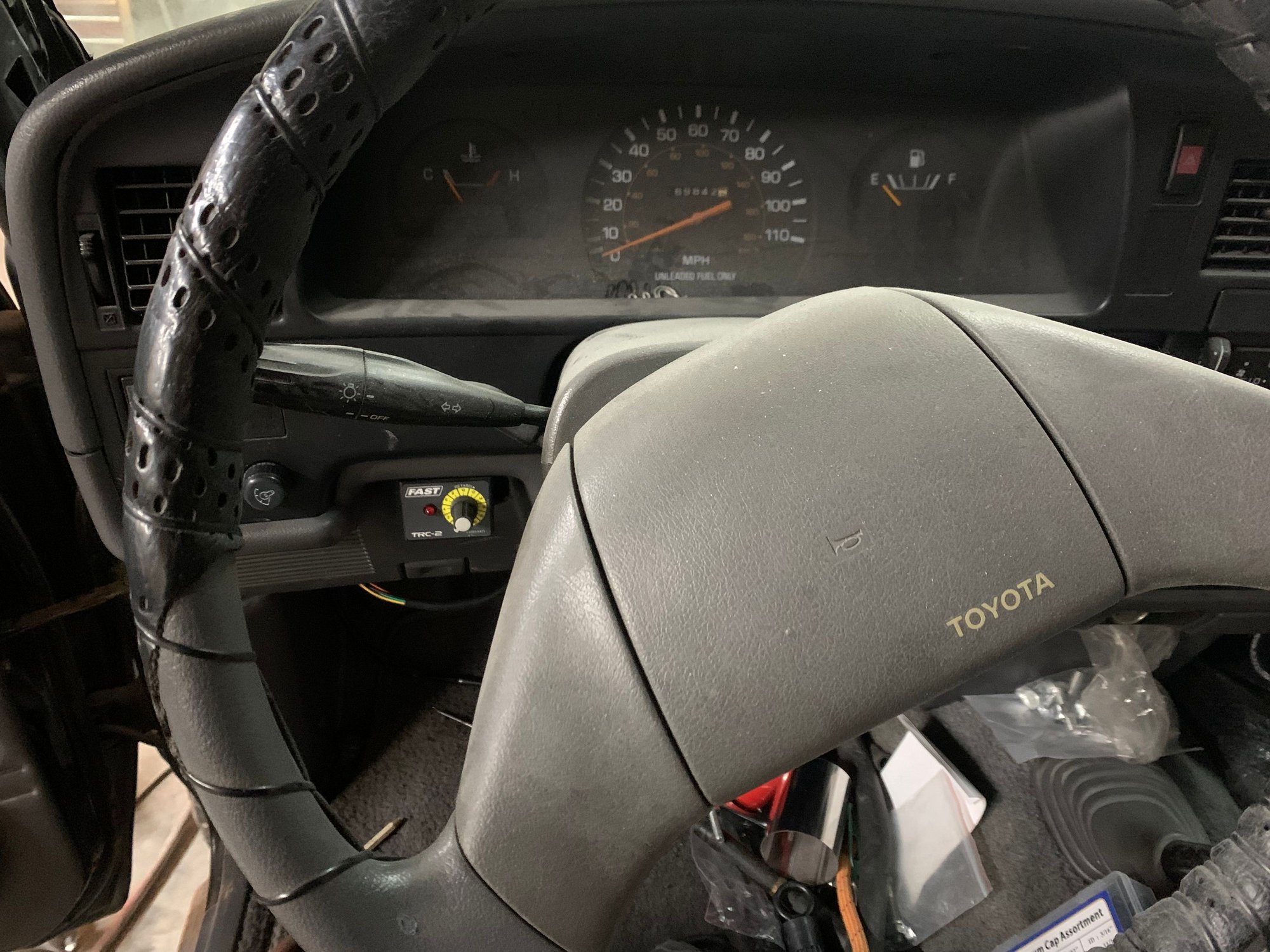

Turbo 3vze
Rear mount turbo, exhaust side is down just have to make the turbo back/downpipe! Still have to connect cold side to turbo and run oil lines.
Has alot of goodies and I’m looking for insight of other things I need to do to make this work!
I just rebuilt the motor due to headgasket failure… now it has hyperpnuematic pistons(for boost), stock rods, stock crank, brand new bearings, all new gaskets, Copper sprayed mls headgasket, DOA cryotreated head stud kit, 4 hole injectors, magnecore spark plug wires, FAST coil, Fast I6, TRC-2 with proportional boost sensor, wideband o2, intercooled, hybrid t3/t4 turbo, 400hp rated clutch, new flywheel, new pilot bearing and throw out bearing, marlin crawler thrust washers, 4.10gears(oem for my truck), electric fan converted, egr delete, vsv delete, cat delete, charcoal canister delete, pcv system switched to dual inlet catch can, still have plenty more to upgrade and I’m sure I’m missing plenty of things!

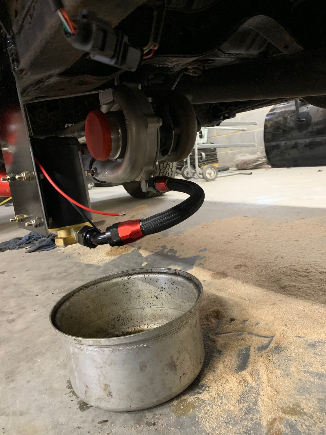

Update on turbo 3vze
I haven’t had much time to work on the ole girl, got a scavenge pump on it now and have the oil feed and return setup, charge side and intercooler is completed, I ordered some clamps and a o-ring fitting to run a rising rate fuel pressure regulator

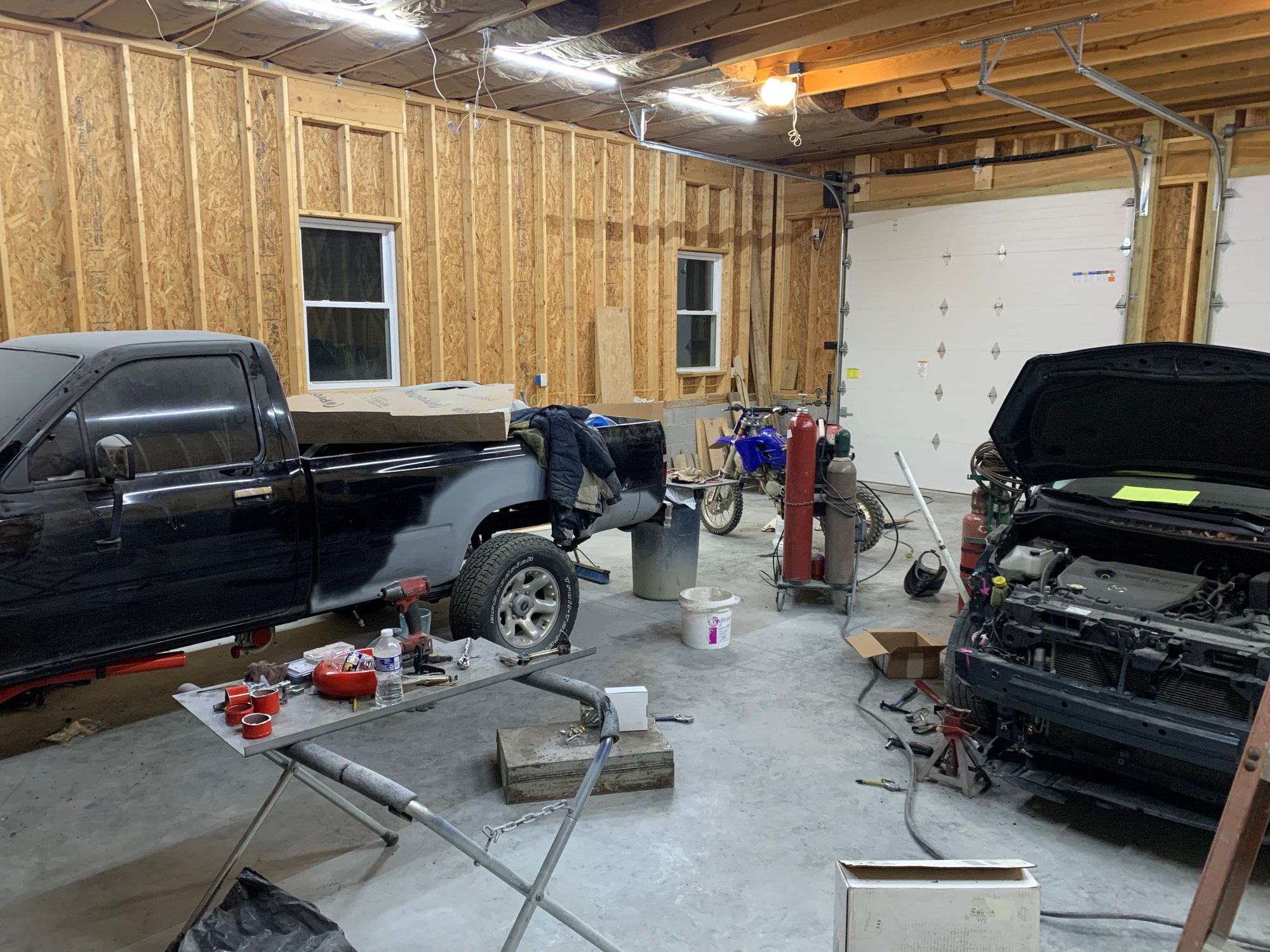

Well it’s been a long road I had to stop working on it for a while but I’m back to it with many changes and big progress!
Bought a TIG welder and built this custom pipe
Added a flex pipe and y pipe to it
Mounted the turbo and Relocated the scavenge pump
With this new set up it lifted everything up about 6-8inches giving plenty of ground clearance and hiding the setup much better.

Nice fabrication of stainless piping.
Why did you cover the ends with a line connected to the end? Flowing some sheilding gas in while you weld it? looking good for sure.
