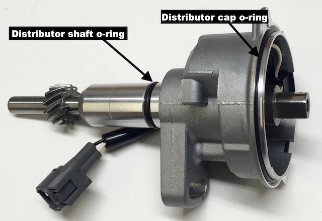

Here are the OEM part numbers:
dist cap
19101-35180
dist cap o-ring 90099-14090
dist shaft o-ring 19127-15021
dist rotor 19102-73021
wire set 90919-29055
plug denso W16EXR-U (.031 gap)

Ordered everything except the distributor shaft oring, that’s only needed if I was pulling the distributor right??
I did get the cap oring. Not sure why you listed the shaft oring so thought I’d ask. Perhaps there’s a reason this is needed when replacing plugs and wires?

If you are not pulling the distributor, and it's not leaking, then you don't need the distributor o-ring.
When you change the cap o-ring, let me know if it disintegrates when it's being removed. Mine did on my 92.

I listed it for future reference just in case this thread pops up in a search. I did replace mine since I had the head off at the time, so it was a no-brainer. Also, my truck is from Arizona and almost all the o-rings on my 30yr old truck were pretty brittle.
I do like to put a thin layer of dielectric grease or silicon lubricating grease on o-rings for a better seal, easier removal, and keeping them from drying up.
