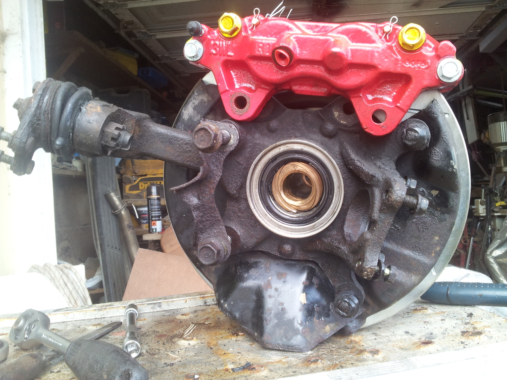

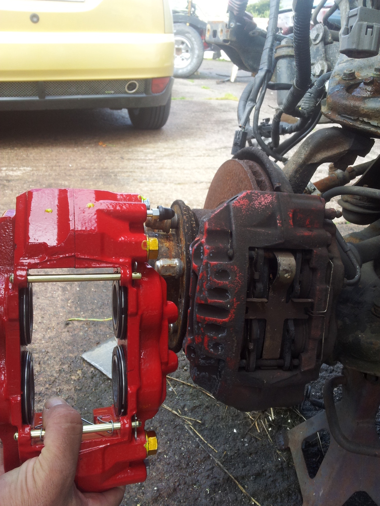

first removed the whole assembly out to start checking how to fit it, and see what the differences in sizes

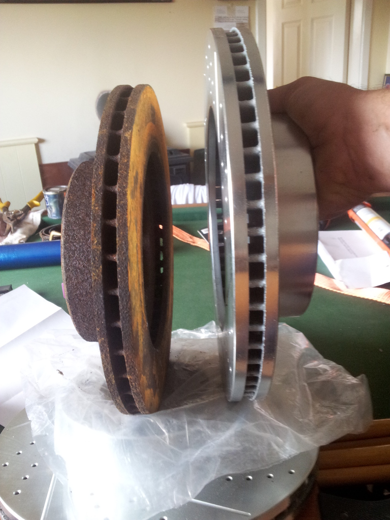

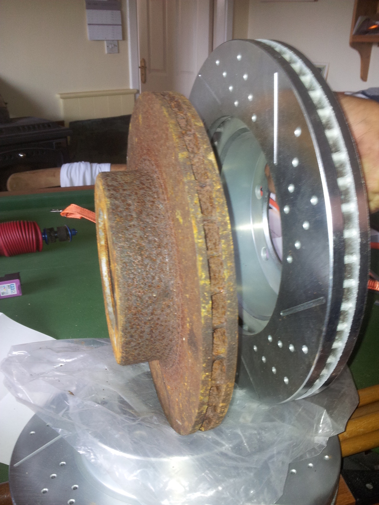

few pics for comparing (ish) the size of calipers, and disc.

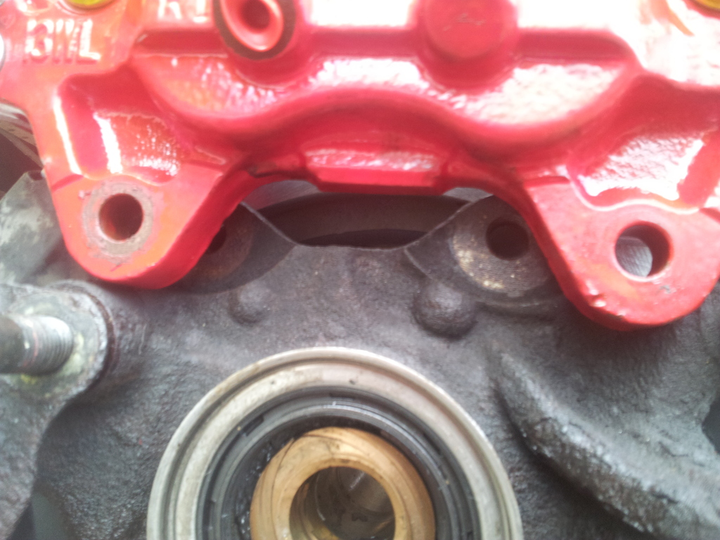

calipers bolt pattern dont match

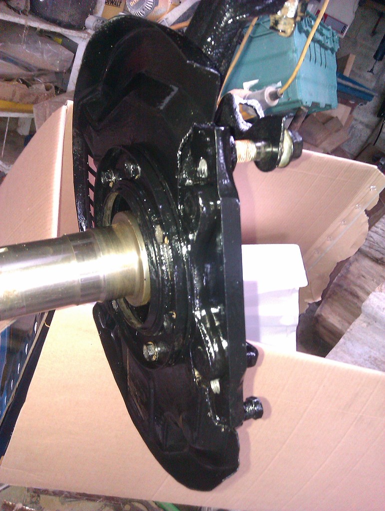

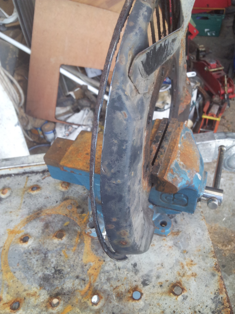

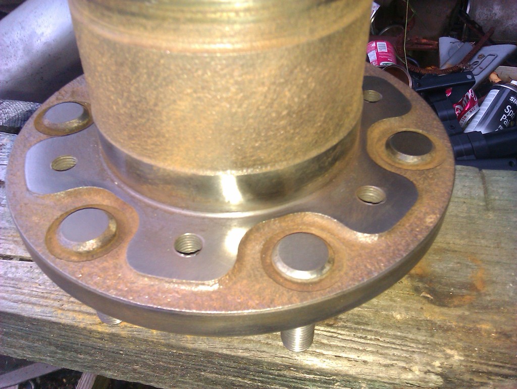

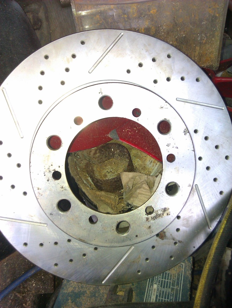

the disc its touching too much the dust shield,so need to trim it (about 10mm around) and i will shave behind the hub, to leave it level to the back of the wheel studs

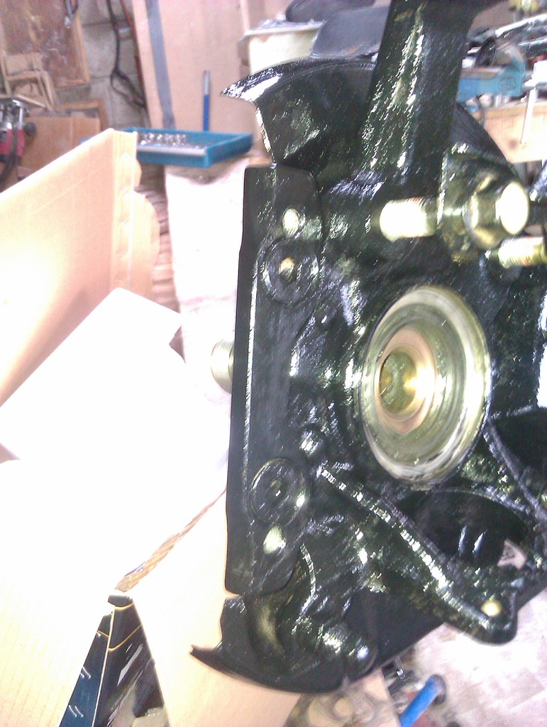

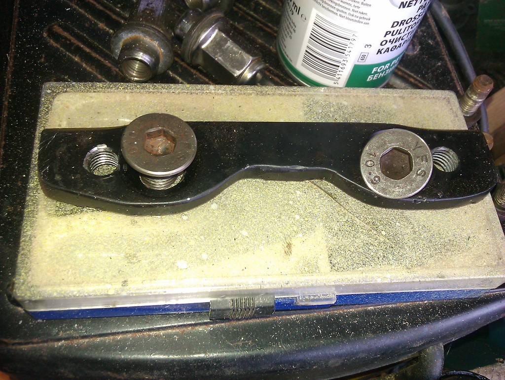

drilled holes to fit it like the factory discs
brackets made
and fitted
sorry, not the best pic

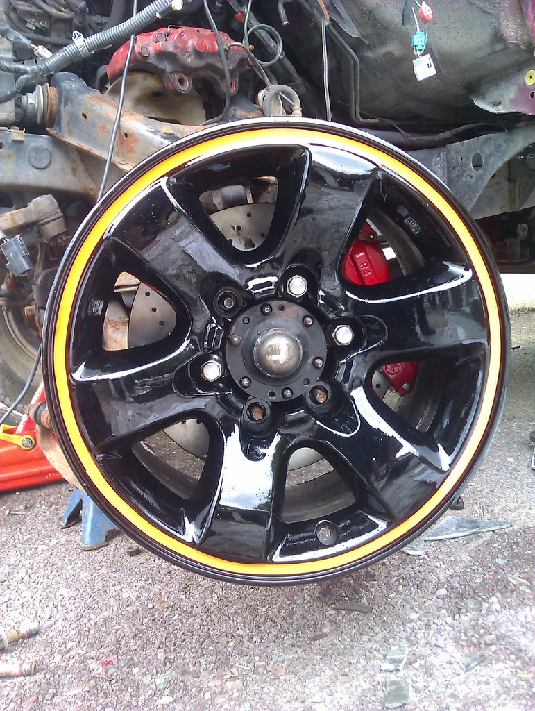

then, the end, on 16s, nissan patrol wheels, not sure if 15s will fit, still some space around the caliper and wheel
now, wait till i got the paint job finish to fit it all with some 305/70r16 tyres

Do you have a better picture of the bracket mounted, with and without the caliper?
While looking at various other brake upgrade threads (or maybe it was the widening a SFA with IFS parts thread) there was some discussion of people not trusting an add-on bracket for the caliper mounts (I'm not sure that I completely understand their concern) but are you worried about that bracket failing?

im open to new/better ideas,
i asked several engineers, some said to weld it in position, some told me to leave it like this, yes, i will take some more pics, thanks.
