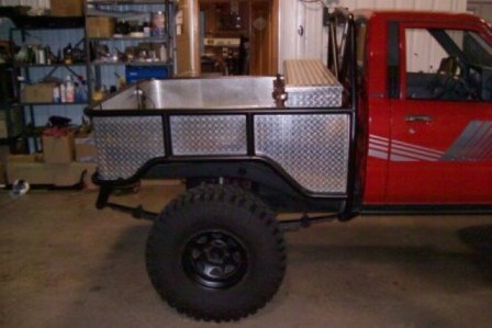

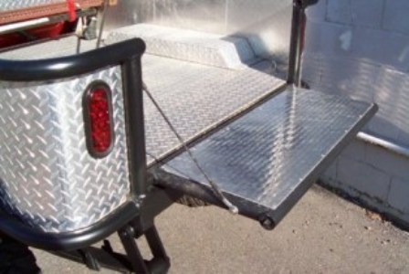

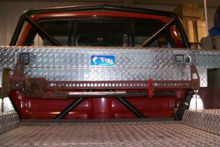

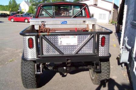

I used 3/16"rivits and an L shaped rubber seal so it wouldn't rattle.
The hardest part of making the whole bed (tube bending included) was the rear diamond plate corners. I made a cardboard template so I knew the shape was right and cut out my pieces with a jigsaw (use an aluminum cutting oil, it makes cutting a ton easier. Then I had to heat up the aluminum and bend the diamond plate to fit. By bending, I mean standing on the each piece and pulling up and hoping to god I got the radius close. Keep in mind this stuff is way thicker (nearly 3/16") than the material used to make toolboxes and truck bedcaps. Shockingly enough though, they fit great.

how did you attach the tread plate to the tubes? tabs?
actually, you do have the laws... they are Federal laws.

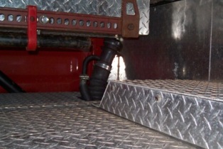

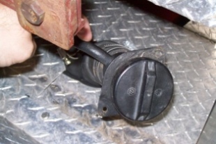

What'd you figure out for the gas filler neck? Do an inbed type thing? Cause the way I just did it was to cut down the hoses so it'll tuck up nicely under the bed once I make my own tube/flatbed.

I ran it inside the bed and didn't alter the hose(s) at all. From a distance you would think it goes into my toolbox. Actually, running my filler neck into the toolbox was my original intention, but I have a slimline toolbox so it would have been a pita to get at with tools and such in there. I will post a couple of tiny ass pics, so put your glasses on everyone. (I still can't figure out why none of my pics are loading as thumbnails, I checked that photobucket deal, but no dice. I think I am just going to start taking pics in a lower resolution.)

wheels/tires extending out too far from the side of the bed, no mud flaps... side lighting... reflectors... back-up lighting... license plate lighting....

Here is how the fuel filler goes through the bed. Its ends up just below the toolbox.

Thanks for taking the time to show everyone your pics. That's one of the best jobs I've seen.
Good call on the plating inside the tube framing. When building fences for large animals, you HAVE to install the fencing inside the posts. Otherwise, the pressure they exert on the fencing causes fasteners to fail over time. All the force is on the posts, not the fasteners.
