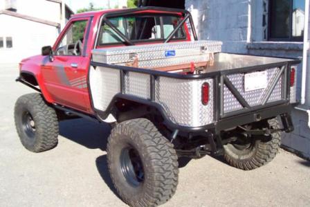

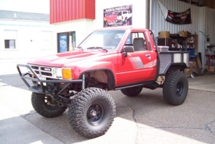

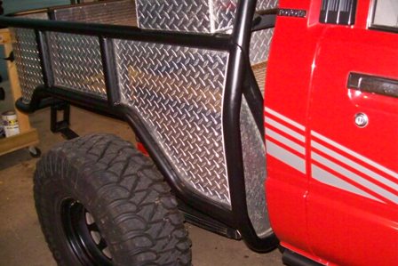

I thought I would share some pics of my sas'd 87. The bed and tailgate may help some of you guys/girls when making your own. All of the tubing is 1.75" and the diamond plate is nearly 3/16" thick. I have owned the truck 5 years now and did the sas and bed last summer. I made the tailgate a couple of months ago. It works by pulling up on the bottom of the hinged license plate frame up. I could have made it simpler, but that wouldn't have been fun.
Tube bed/tailgate pics, enjoy.-100_0011.jpgTube bed/tailgate pics, enjoy.-100_0014.jpgTube bed/tailgate pics, enjoy.-100_0027.jpg
Sorry about the thumbnail pics, click for larger view. I have more pics if anybody needs to see different angles.

I haven't had anybody pull me over yet (over 1 year like this) and it is my dd. I have had state patrol behind me on the freeway and they leave me alone. This was built to drive to the trails (closest is about 90 miles away) and wheel hard. I do plan on re-registering it with hobbiest plates now that I have another vehicle for winter. Too much hard work went into this to let the salt eat it away.

No biggy, my thought was to make it so the diamond plate wouldn't get ripped off by the trees and rocks. Also, I load it up with a weekends worth of crap(coolers, spare, etc.) and I would rather it be pushing against the tube than away from it. It is done in sections so removal is easy and you dont see the seams from the outside.

how did you attach the tread plate to the tubes? tabs?
