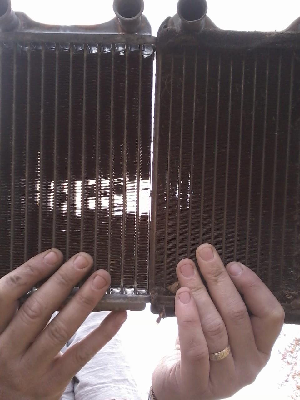

If this truck did not have AC installed, alot of debri gets in thru the cowl in front of the windshield and goes thru the blower and straight to the heater core. Also if take off your front mudflaps and find alot of debis behind the inner fender that can be sign of trash blocking off the flow. Even with AC dust can get into the core like below.
Here is what I have ran into and either earlier or later in my thread I show it in worse shape then this https://www.yotatech.com/forums/f199...l#post52151096 The ventilation system gets dirty in these. The debris could even block off the condeser and keep air from moving thru the system. I would look at what others have suggest first and if that doesnt fix your problem see about the gunk in there.
The one on the left is new, the one on the right has the fins clogged. You could feel the hot water cicrulating thru the pipes on the firewall but no heat to the cab. If this isnt the problem, I have flushed my cores with CLR.
