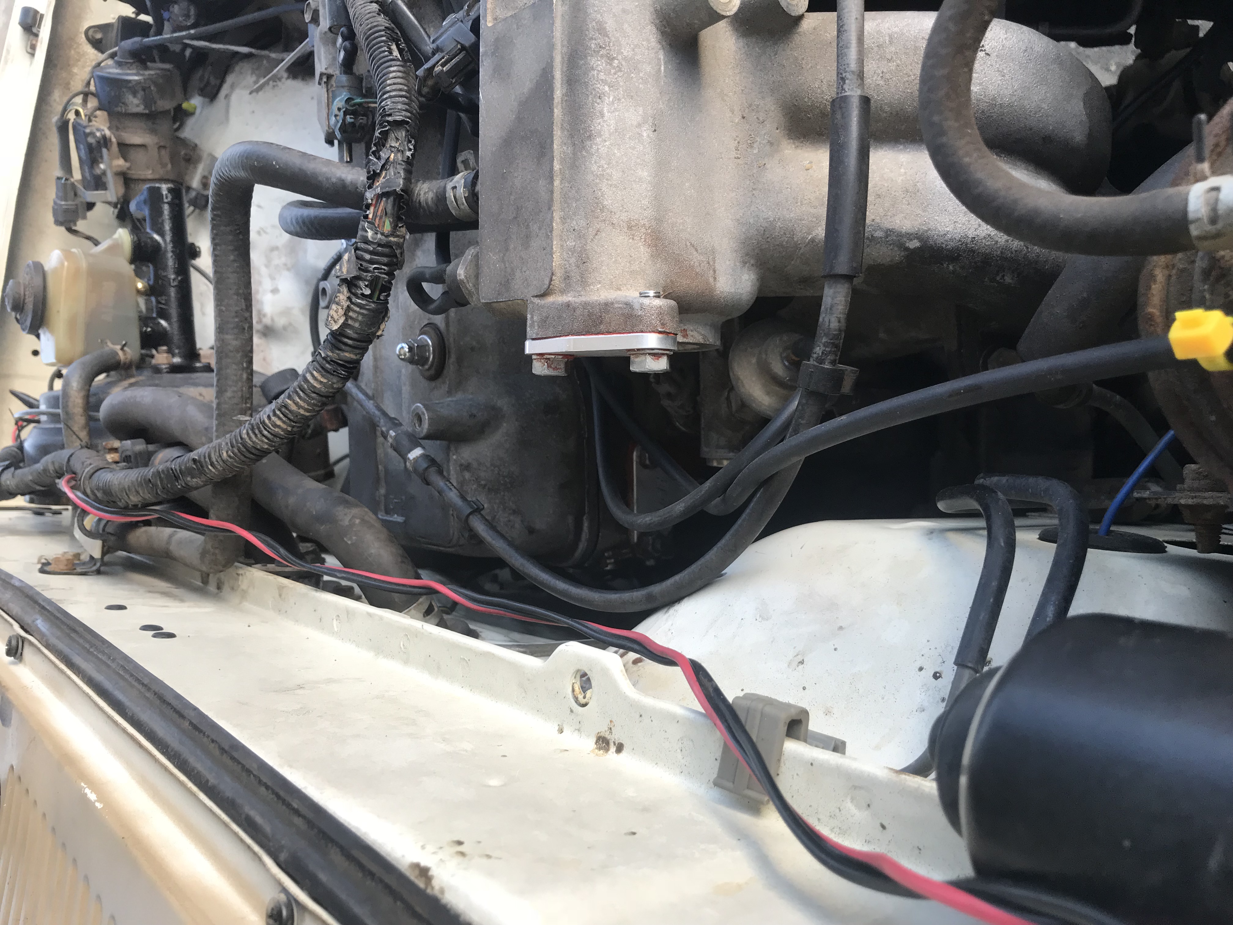

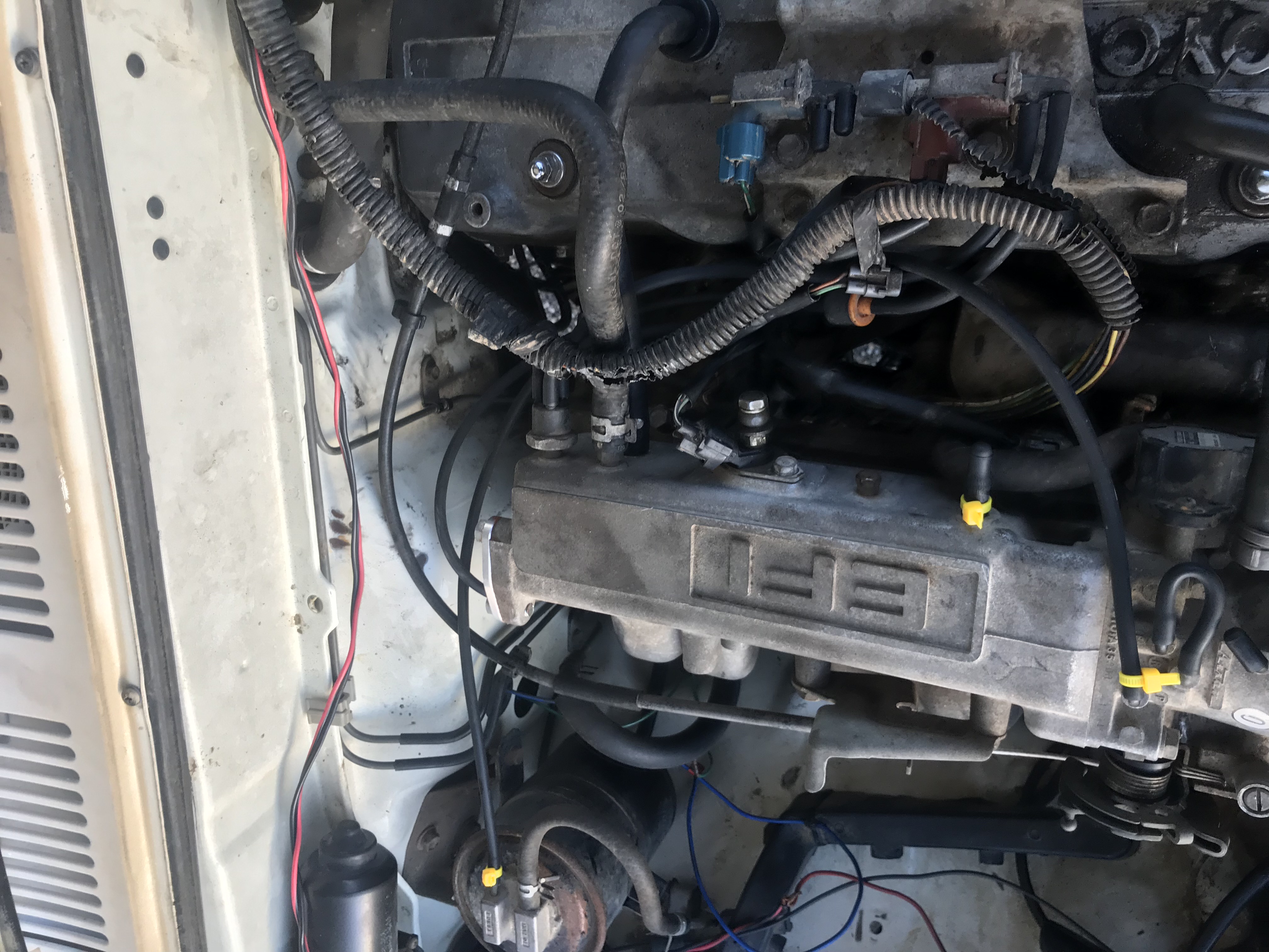

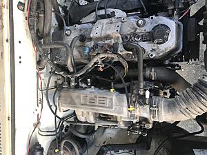

Intake pics/throttle body ( routing of smog stuff help)
What you all think? Advice or did. Do something wrong

Looks like your Fuel Pressure Up VSV is missing on one of those pics.
See this and
See Scope's explanation here.

id be trying to spray water in a very small spray around each hose infividually and see which makes it stumble. looks like uve tried to use hoses that are a bit loose and zipties em haha. good try, but it never works with vacuum hoses.

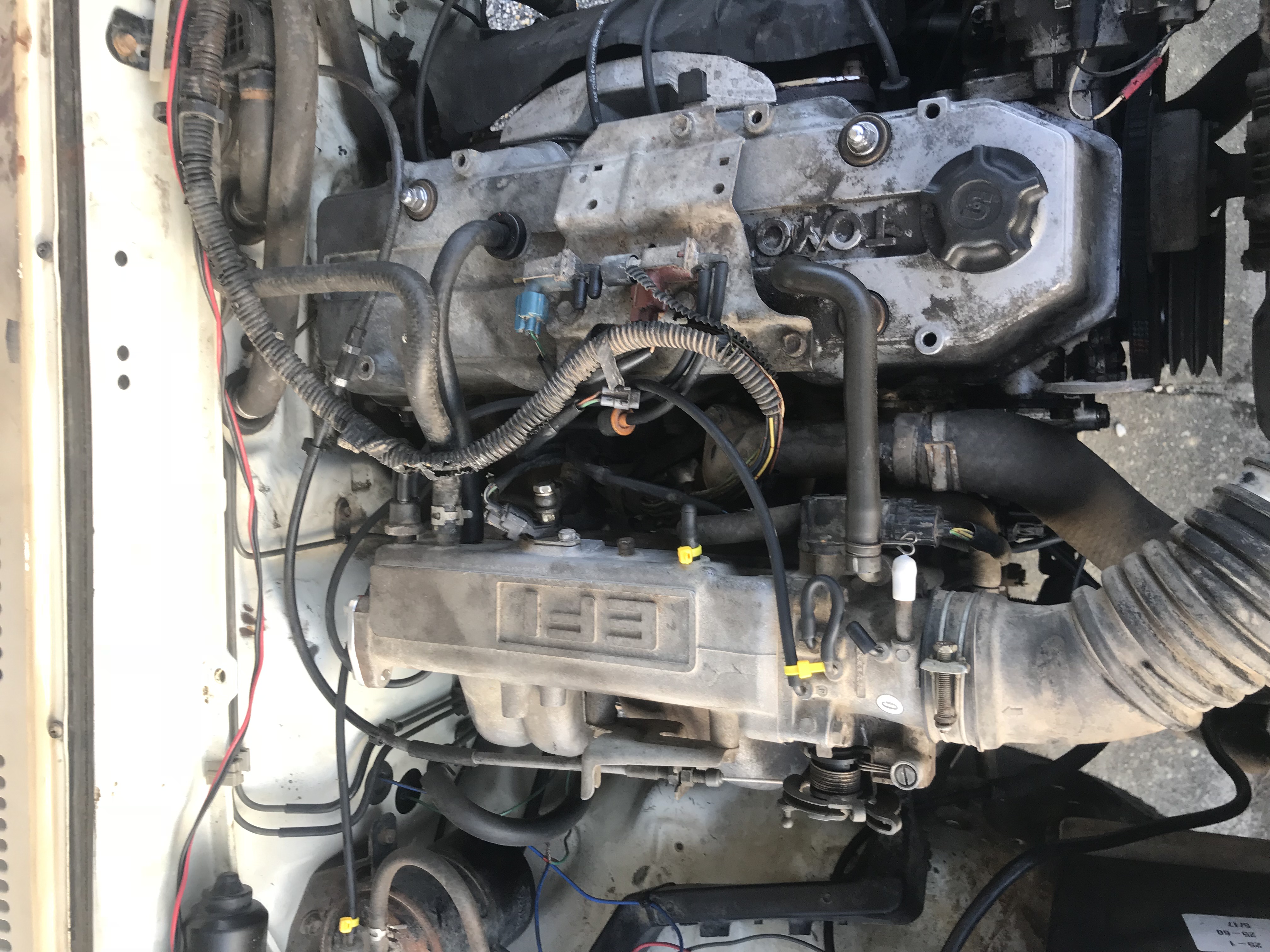

Hose on I take was not put on right side
you all were right, the hose you labeled in red was hooked up to the other connector and the open air was chasing the changing in fuel pressure . Silly mistake for sure but makes sense in order to keep the fuel pump pressurized . I'll send pics in the am when it's daylight

Actually,
1) If the hose marked in red above were not hooked up, your intake manifold would be sucking air; that's a major vacuum leak. That causes stalling or idling issue.
2) If the wire hose marked in blue were not hooked up, it exposes a mechanism in the fuel pressure regulator to atmospheric pressure (higher than vacuum) and raises the fuel pressure, but you would not see that without a pressure gage.
