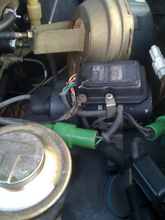

Here's my 86.

those pics show the coil, right? I know its a dumb question but I am still trying to find out what the igniter looks like. According to Haynes it is mounted on the coil with four bolts and its a square metal device.......

Coil and ignitor on my 87 4Runner.

Mine is an igniter/coil combination. If you look close, it even says so. It's original. I don't think much changed between 86 and 87.
I don't know what year Toyota stopped using points, but the distributors in 86 didn't have them. Sounds like someone swapped in an earlier motor, or at least hacked in an early ignition system.
