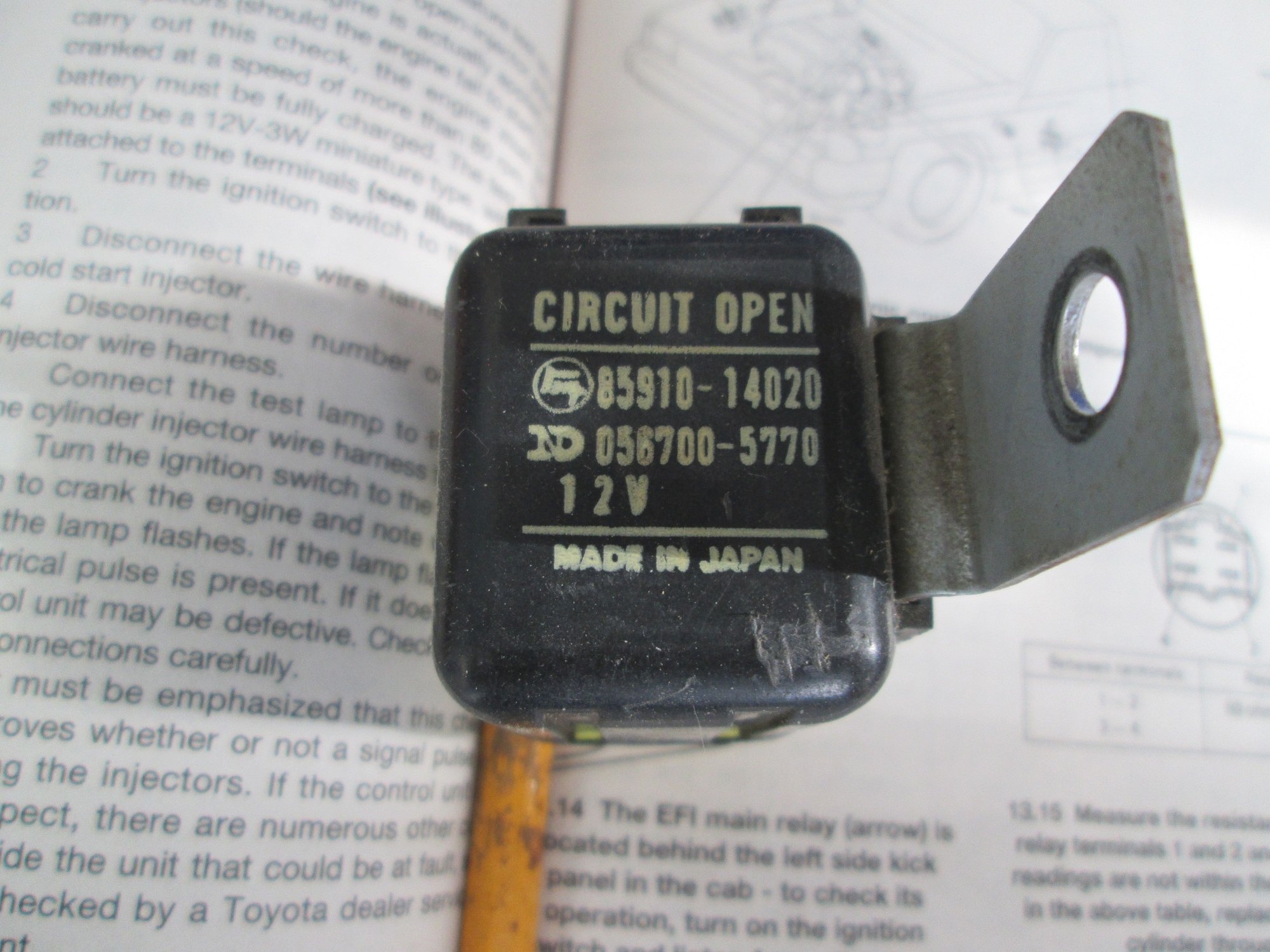

The circuit opening relay is showing 9.52 volts when cranking.
Resistance between STA & E1 is 22. they want 17 - 25. Between +B & Fc is 111. they want 88 - 132. Between +B & Fp is Infinity, again on my ohm meter I get 1 and no other readings.

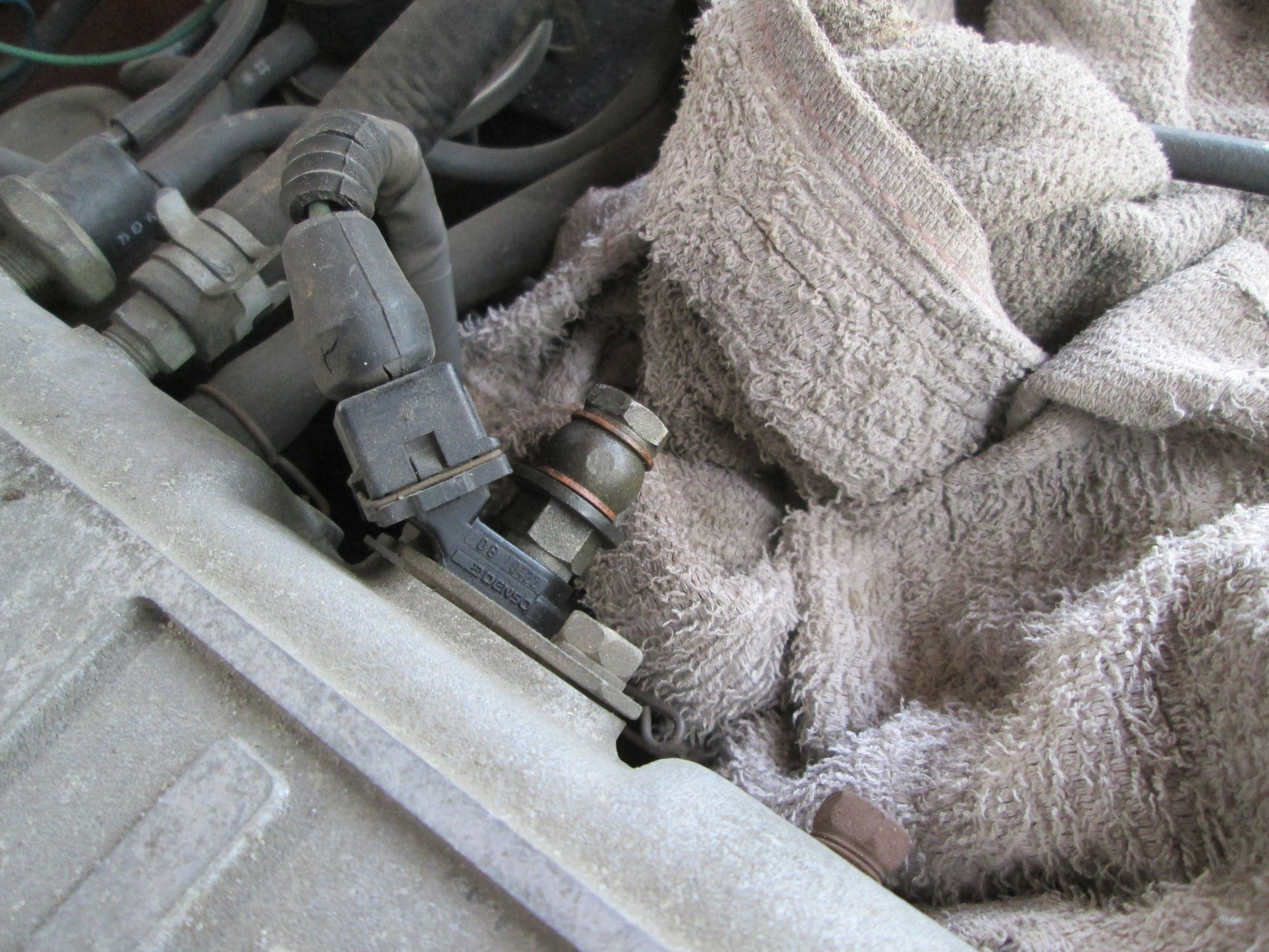

I did the jump FP & B+ to bypass the circuit opening relay, cracked the line on the cold start injector, turned the key on but got nothing.

if you have the ignition key on with FP+ B jumped and no gas getting to cold start injector, sounds like fuel pump is gone.

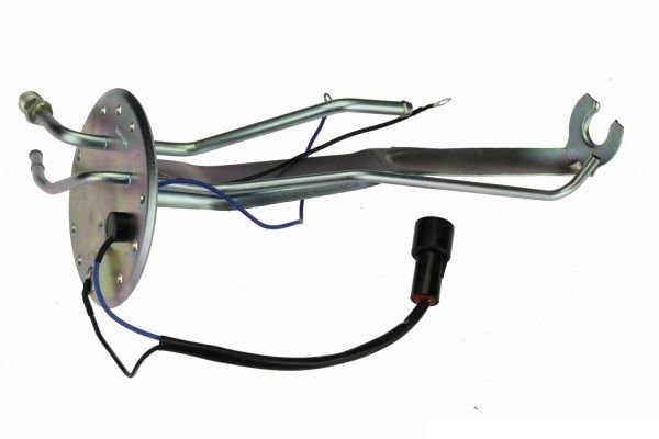

Fuel pump, fuel filter clogged, bad wiring back to the fuel pump, or bad connector(s) on the hanger assy. My bet would be the fuel pump, especially if you can't hear it running. Having said that, make sure you have power to the hanger on the tank the fuel pump hangs on. If you do, and I bet you do, you can pull the hanger off, and check the power at the pump.

Anyone know of a source for one of these? really hard to find it looks like rock auto might be the only place.
