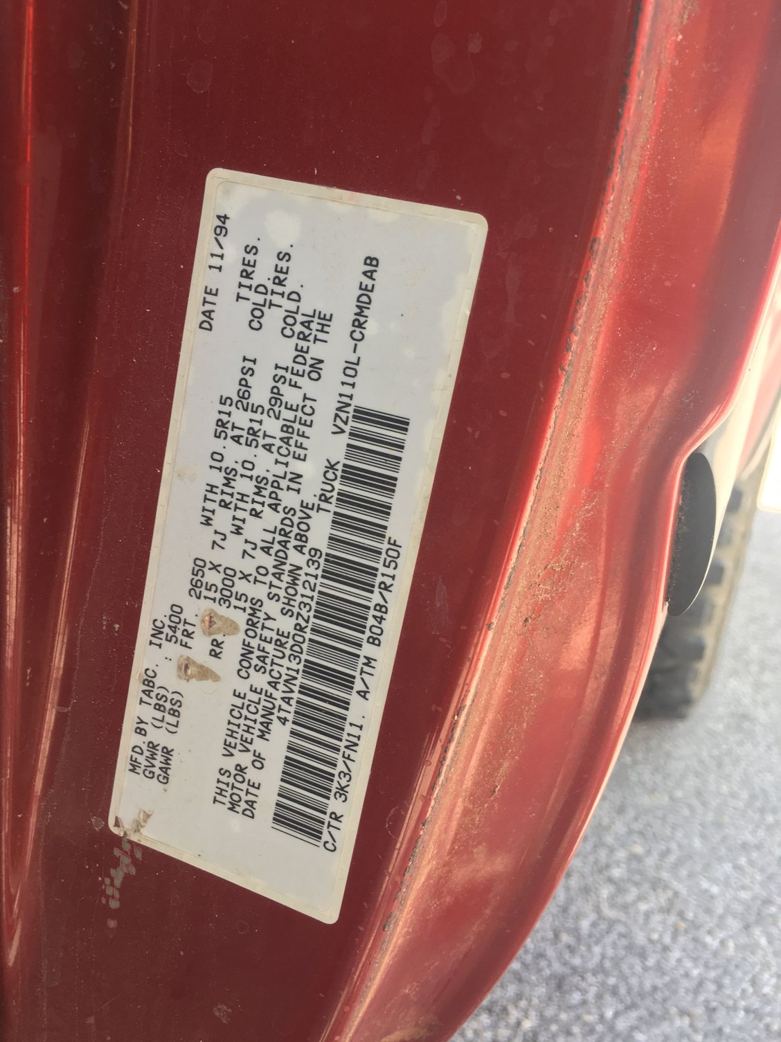

So I just picked it up. Thanks all for the advise. The truck has 196k on it. It has this and that done to it and the guy that owned it before me replaced the timing belt himself (it works great) so I would imagine at some point he changed the transmission fluid. But let’s say he didn’t. Also let’s say none of the previous owners did either. So I’m at 196k and asking them to do it. Then I pick it up thinking it has been done (because they are telling me it’s done and because they did transfer Case and not transmission ) and off I go for another 60k or whatever the interval is. Anyways point is thanks for all the help on here. Good group of guys here.

Does this mean I have the R150 transmission or the other mentioned ?

You have the R150F. See the bottom line of sticker, below bar code, right hand end of line.
Also, the B04B immediately preceding the R150F is the axle (differential) code, indicating that you have an 8", 4.56 ratio, 4 pinion differential.
All of this is completely stock and normal for a '94 V6 5 speed.
The VIN starting with 4T means your truck was made in North America, not Japan.
