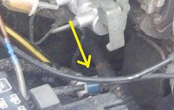

on these truck you should have add (auto disengaging diffs) the system should be vacuum run you will prob find that the one way valve is blocked and the solenoid on the front diff has locked in place check the valve and your vac lines from engine to vac tank and vac tank to diffs its always usualy the valve thats blocked though. the other common fault is the vac tank is behind the right hand side wheel arch lining and they do corrode and leak which then causes the solenoid to kick in and have permanant 4wd be very carful trying to force it in to 2wd or you might end up getting a new diff. the diffs can change on the move but not above 15mph as the crown gears cant engage properly and you will smooth off the cogs in the diff. the valve im on about is a one way valve and is the blue cylinder thing in the pic. if all is ok its the actuator/solenoid fitted to the front diff on the front of it. unplug it and attach a 12v supply a listen/feel for it to click or you should feel it open close if you hold it while you check it, if it doesnt click or vibrate then its that that is fubar and need to replace which isnt a very hard job at all. hope this helps you all.
