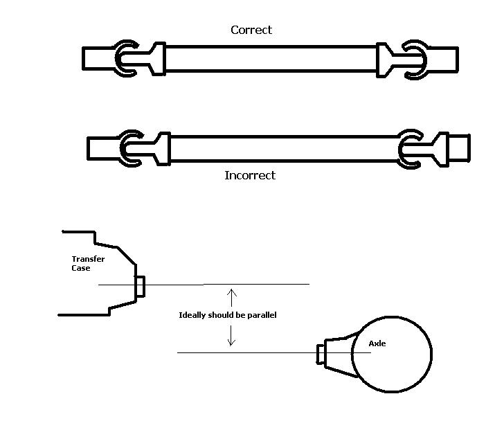

Dude! Lemme start at the last bit - taping up your driveshaft is a bad idea, even though tape isn't heavy enough to unbalance it much.
First, when you r&r'd the shaft did you pull apart the slip joint? If so, did you make certain you put it back together the same way? When you did u-joints, did you make sure it all got hooked up again with the u-joints in phase? U-joints out of phase could be all it is.
Next, when you lifted the rear axle you might have changed the pinion angle. Poor driveline angles can cause horrible vibration. I'd check that too.
THose two things (one or both of them) are probably all that's wrong. If they are fine, then have the driveshaft checked for true and balance, and look for bent output shaft etc.

I out the u-joints in correctly. I watched the phase. I even took the slip yoke appart at least 12 times and turned it out of phase to see if it would get better or worse. It stayed the same. Where you got me is the angle of driveshaft. By theory the angle at the front of the driveshaft to the trans should be exactly the same angle as the driveshaft to the pinion like your diagram illistrates. But with the Trailmaster lift and having the 4 link stock system which runs coil springs there is no easy way to adjust the pinion angle like leaf suspention systems using wedges. What do you suggest? The longet I drive it the worse the noise gets. Once again I can not believe I can not find any bad or wore parts.

I FIXED IT AND IT WAS EASY. The bottom line is this and this is VERRY cridical! You can not have anymore than 2 degreese drive shaft angle differance from your front universal and your rear universal. You will have a awlfull rumble and it will sound like gearing somewhere or like you said chainsaw. OK here is a VERRY EASY FIX. This should reduce your noise and maybe eliminate it all together like it did for me.
LOWER YOUR TRANSMISION CROSSMEMBER BY 3/4 INCH.
Detatch your transmision crossmember at the frame rails. Lower the crossmember and put in a stack of washers that add up to be 3/4 inch. You will need 8 stacks and longet bolts. With a 4 inch lift this will put your driveshaft angles at 1 1/2 degreese differance. You can lower it more if you like or if you are still getting the noise. I realy did not want to lower my crossmember and gile up any ground clearance but I was on the rocks today and I see no problem with dropping 3/4 inch. Good luck, it worked for me!!!!!!!!!!!!!!!!!!!!!!!!!!!!!!!!!!!!!!!!!!!!!!!! !!!!!!!!!!!!!!!!!!!!!!!!!!!!!!!!!!!!!!!!!!!!!!!!!! !!!!!!!!!!!!!!!!!!!!!!!!!!!!!!!!!!!!!!!!!!!
