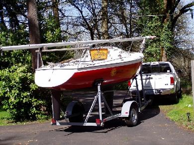

I pulled this all over Oregon with my 85 4Runner. A buddy pulled his (same boat) with a friggin Subaru wagon for many years. FYI the boat weighs 1350, the trailer about 900, and I figure sailing gear, camping gear and beer for a weekend regatta is at LEAST another 500 lbs. Figure close to 3000 lbs all done. No worries.
