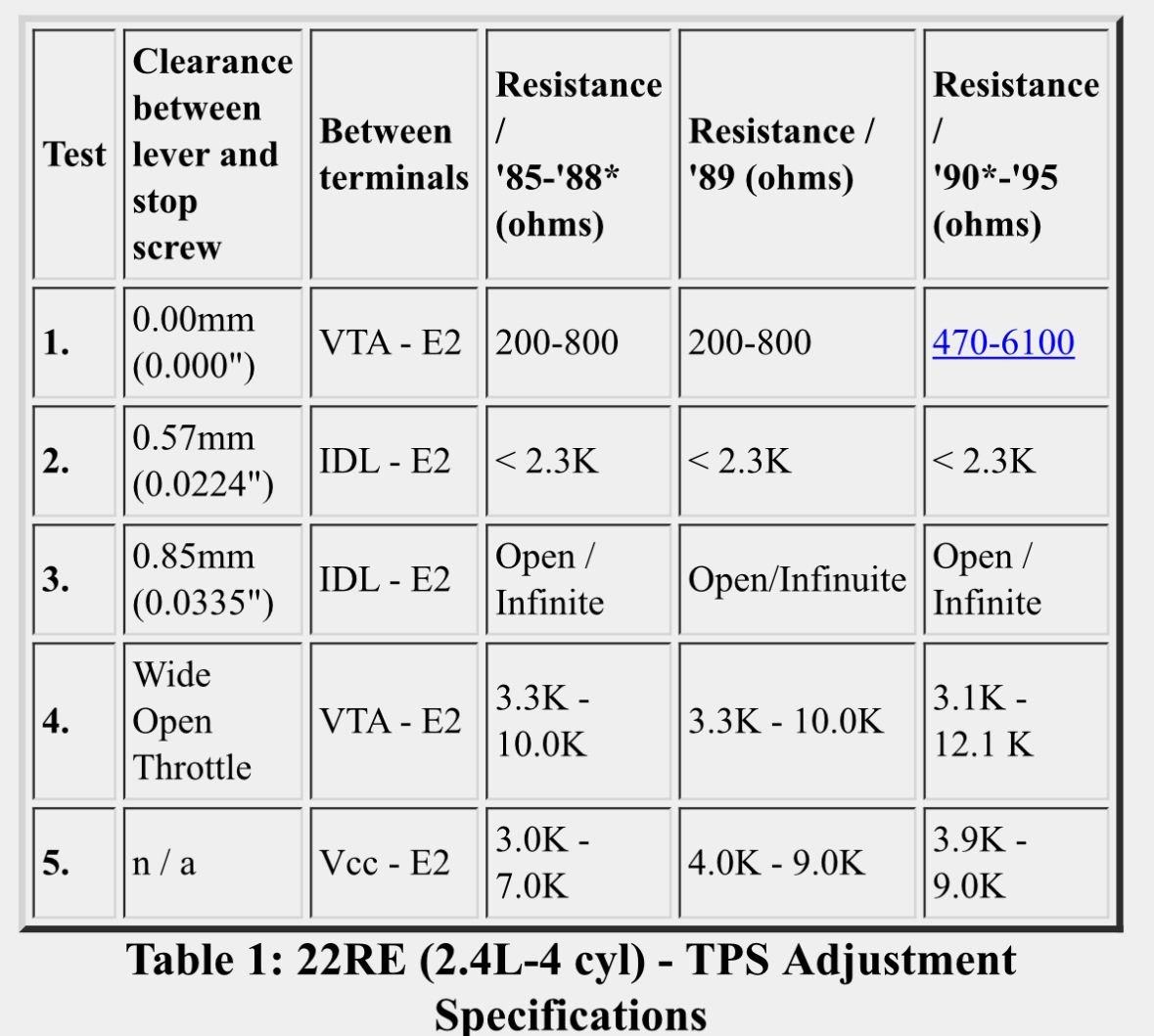

So I had to take off the intake manifold to replace the notoriously hard to reach fuel filter, and along the way I ended up unscrewing and removing the TPS like an idiot instead of simply disconnecting its electrical plug. Now that everything is back on, Ive followed the instructions on lcengineering pretty obsessively regarding the TPS adjustment, and I get get 4 out of the 5 tests performed on the multimeter to pass - except for the VCC - E2 test (the last one).
No matter what I do for that test, it reads as an open loop, in any throttle position. Is it possible Im doing something wrong, or does the TPS need to be replaced? I appreciate any guidance that anyone can give me on this.

Originally Posted by millball
Only one TPS adjustment is possible.
That is the throttle closed/ throttle open adjustment.
Im assuming then that youre referring to tests 1 and 4 in the attached image since test 1 seems to meet the condition of completely closed and test 4 is wot? The good news is that I can get those tests to pass.
The other measurements are to determine if the TPS is functioning correctly and is fit for further service.
The only measurement Im having trouble with is test 5, which tests the total resistance of the potentiometer, if Im not mistaken. That appears to be an open loop. Does that mean the TPS is bad?
Jimkolas timing light method of TPS adjustment is the real deal.
Which method is that? I havent seen it yet.

You can set your TPS with a multimeter five times and have the set screws land in a different spot each time.
This is not a hack trick. It's the method factory Toyota techs used bitd. use this link, then scroll down till you see my post.

I'm having SO MUCH trouble getting my brand new from toyota dealer TPS set in test 2 (the important one) I either get Inginity or way above 2300 despite 7 million adjustments and 5 different people trying the test and I've read everything I can find. Here is a portion of a thread about this I'll link.
http://4crawler.com/4x4/CheapTricks/TPS/index.shtml
From what I've read it seems the only measurement that matters is the IDL - E2 so if youre in spec there and everything related to it's operation seems fine then your tps is probably ok.
  • "Test #5 just measures the entire resistance of the outer-most current track seen in Figure 2.
    • This reading will be the same regardless of the throttle opening.
    • It can't be adjusted, so is basically a go or no-go reading.
      • If the reading is within the specified range, it is OK, if not, it is not OK.
So, how do you interpret the above test results and decide if your TPS is good or not? , see the section here for some symptoms of a defective TPS - and if you do not have those symptoms, then it is likely OK as the ECU is the ultimate "judge" of goodness or badness."
I also read that when you jump the 2 terminals to do your timing if the idle drops and you get the check engine light to flash youre good to go. I cant independently confirm any of this info because I cant get my tps set, I am having major idle problems and I can't get my timing set because when I jump the terminals nothing happens and there's no sense setting timing with a bad tps.
If anyone has advice let me know.
