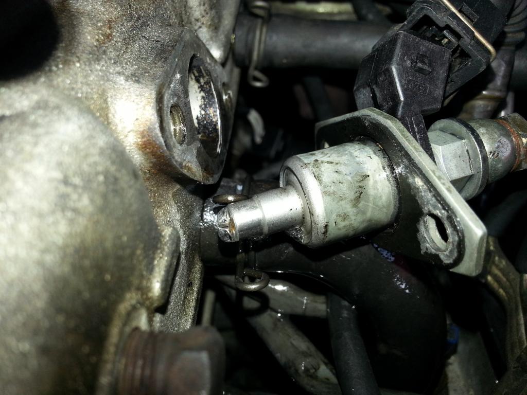

Turns out my CSI was leaking. I jumped the fuel pump and it started leaking. I unplugged the connector just to be sure and nothing changed. It is going back to injectorrx.com. They were more then apologetic. Said he'll pay for both freight and refund what I'm out if he can't correct the problem. TPS is also getting replaced with a new factory part.
