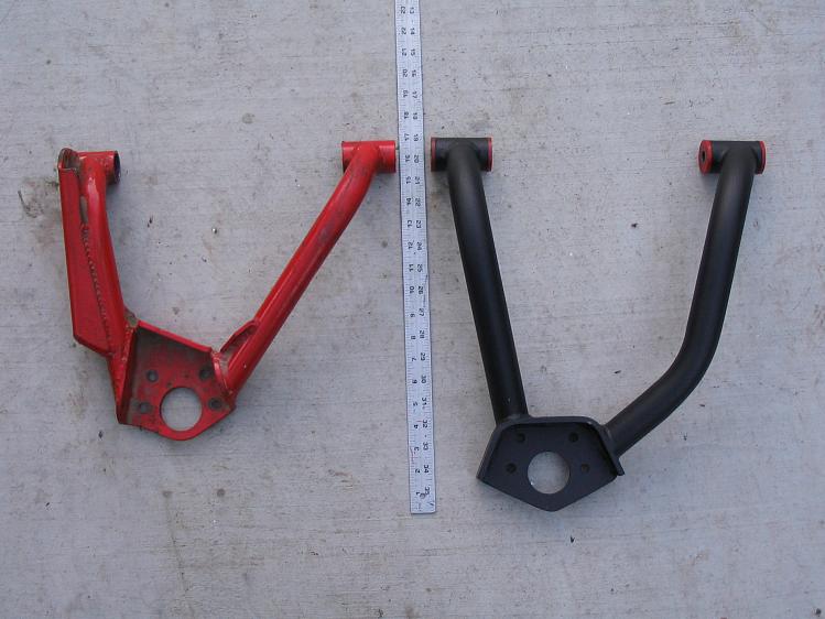

I was thinking and I saw a guy get 12-13" out of stock width arms but he used Rancho UCA's. I was thinking that if you did exactly what he did and then bolted on the extended LCA and bolt on UCA extension onto the Rancho arm if you could get quite a bit more? Probably around 14-15" I think?
I am that guy! The Rancho 3" LIft kit for the 1986-1995 IFS Toyota 4x4 is no longer being made and there are no replacement parts available. Downey did a lot of work modifying the kit at least 10 years back. Their work, in a sense, was one of the first long travel kits for this generation of yota. In developing my Blazeland LT kit I too played around with modifing the Rancho design. The first concern is finding a Rancho kit. I was able to obtain two since I started looking in 1998. If anything is damaged or missing your screwed; even worn out bushings present a major problem since they are specific to the Rancho arms. I didn't look with much effort, but if came across a kit I would pick it up if the price was right. If you find a Rancho kit or have one allready, it can be modified to make a nice coil over conversion LT kit capable of at least maxing out the T-100 CV axel shafts (limits of a about 12" of wheel travel) If you eliminate 4WD you could get a bit more. I built three versions of the Rancho Gen II LT kit. I got one design to cycle 13-14" w/out 4WD. I think this concept could be tweeked to get a bit more but it gets expensive. The factory Ball Joints and Tie Rod Ends get maxed out and you would need to be switch to heims joints and uniballs. I ditched the Rancho Gen II kit when I stuffed the front end into a ditch. I bent stuff that was prohibitively expensive to replace. So I went back the the Blazeland LT, and since I was running 4WD the extra couple of inches of travel the Rancho Gen II offered were not being used.

Originally Posted by camo31"10.50"
i've heard of ALOT of guys having problems with the Rancho UCA's...so i'd watch out..they said the UCA's tend to break in half..although i'm guessing you could probably brace them up to make em stronger..
Yep, the Rancho arms are weak. I broke one and cracked welds on another back in 2002 Baja 250 pre-run. I would NEVER try bolting a Blazeland UCA extension bracket onto a Rancho arm. I did it, but only to develop the geometry to build a whole new set of arms. If you were to do this, ditch the torsion bars and go coil over. The TBs on the Rancho design dictate that TBs move up in down with the UCA to some degree. Its better to utilize the stock cross shaft configuration if you want to run with TBs. The extra length Rancho gen II UCAs just put too much load on the TBs and related componants. With a coil over conversion the loads holding up the weight of the truck are transfered to the LCAs letting the UCAs concentrate on a different set of forces.
