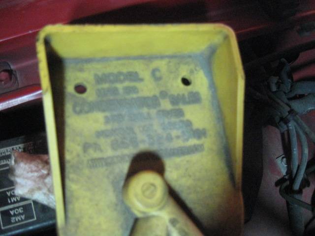

I also ran a Condensator on this truck pretty much from the beginning. It is essentially an airline dryer filter which runs between the PCV valve and the intake which keeps all the crankcase crap out of the throttle body to keep the intake charge going into the engine cleaner. After I installed it on my 88, the truck started better and would take off ramps from the highway in higher gears then what it did before. I have it on my 94 4Runner now and it keeps that stuff out of the intake.
You can build your own which at the time I bought it, I didn't know. Check out this link:
http://www.cleanmpg.com/forums/showt...?t=6417&page=4
An older gentleman from Montana I believe invited this some years ago. He passed away and the technology was bought by this company:
http://www.worldnci.com/
They are charging more than what he charged.

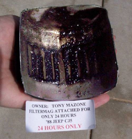

I also had a Filtermag on the oil filter from the beginning also. I used a K&N #1002 and then switched to the taller #2009. I also used Mobil 1 #M1-209 filters also. I believe in the Filtermag because I have the first filter I had it on in my 96 Ford pickup which I cut open to show the metal grit that the filter misses sticking on the side of the filter. I will post pics later because I am at work now.
I was just curious to see what others thought of the higher factory oil change recommendations. I just think that some people change the oil way too early than is needed. That 88 22re ran strong but that H/G was too bad. I just think the Filtermag is cheap insurance and common sense. It keeps the oil cleaner by keeping out all the metal particles that cause wear in the engine. Therefore running the oil longer wouldn't be a problem. Just my $0.02. Here's the site:
http://www.shopfiltermag.com/
http://www.summitracing.com/search/B...ew=ProductName
I would love to have had an oil analysis done at some point on that truck. Maybe I will have to do it on my 94 to see where this stands. That was a motor with over 150000 miles on it when I got it, so doing the longer changes did not bother it. As long as compression is good and the motor is running well, the motor is not using a lot of oil and the fuel mileage is where it's supposed to be....I don't see anything wrong with going longer on the changes. Thanks for reading.
Attached Thumbnails Toyota factory maintenance oil change schedele 22re/3vze-fm_arrow_an.gif   Toyota factory maintenance oil change schedele 22re/3vze-fmposter112706sml.jpg   Toyota factory maintenance oil change schedele 22re/3vze-phpnkaaeeam.jpg

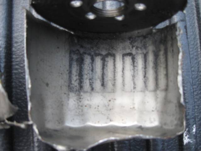

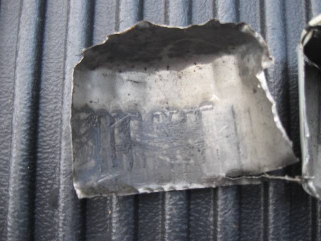

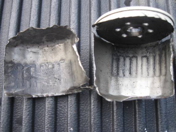

Here's the first oil filter that I ran the Filtermag on...from my Ford f350 351W. I'm gonna buy a oil filter cutter from Summit so I can start cutting open the filters from the 94. I'm also going to buy one of these so I can easily take samples from the oil pan:
http://www.qwikvalve.com/?utm_source...oil-drain-plug
so I can run the extended oil change intervals and know for sure what's in the oil when I get the oil analyzed and post here.
Attached Thumbnails Toyota factory maintenance oil change schedele 22re/3vze-phpdjzxhipm.jpg   Toyota factory maintenance oil change schedele 22re/3vze-phpbrh9ewpm.jpg   Toyota factory maintenance oil change schedele 22re/3vze-phphmi1wypm.jpg

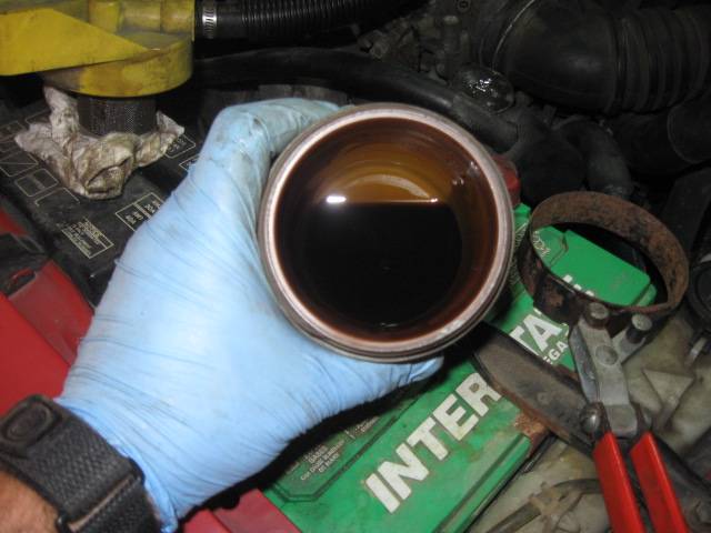

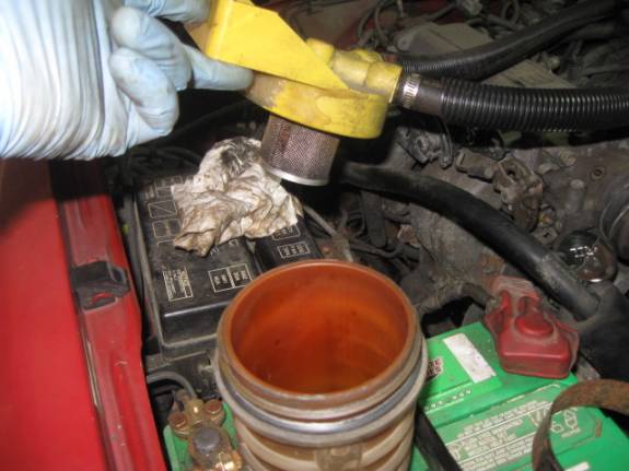

And here's the Condensator which runs between the PCV valve and the intake...I have filled a gallon bottle of black crud from the Ford and both Yotas which was kept out of those engines by these...I have a second bottle started now. I have kept the full bottle to show people. Who wants to send that stuff into the engine and try to burn it off?

I wouldn't waste any $ on the fumoto valve. You are better of putting it towards a magnetic drain plug. Also these catch cans are much better and more compact >> http://www.saikoumichi.com/OCC_explanation.htm

Is there any actual evidence that the metal particles that the magnets catch on the inside of the oil filter would have escaped from the oil filter? If the filter catches small, invisible-to-the-naked-eye particles, then it would easily catch these visible metal shavings, right?

There's info there. The dirty oil comes into the filter through the center hole, passes through the filtering media and then goes along the outside walls to the holes found along the outside of the plate...so yes, the grit you see along the walls would be flowing back into the motor with the "clean" oil. Filters are not made to catch the smaller particles because the engine would not be supplied with enough oil and would burn up.
From Filtermag's site:
Modern oil filters remove particles by forcing the oil through paper-based media with very small ports. The technology behind this filtering media is a compromise that has remained relatively unchanged since the 1930s. While oil is necessary to remove these damaging particles, it is equally important that it flows back into the engine fast enough to lubricate all the moving parts.
A perfect oil filter media would stop all the particles down to 1-micron (about 1/70th the thickness of a human hair). Unfortunately, a filter with ports that small would also restrict the oil from returning to the engine fast enough, resulting in catastrophic equipment failure.
Filter media developments over the years have certainly increased the life cycle for oil filtration cartridges, but fluid dynamics require the ports in the media to remain 25-micron or larger.
Good read also: http://www.carjunky.com/news/motor_oil/mom7.shtml
and here: http://www.precisionenginetech.com/t...lters-exposed/
From this page: http://www.aa1car.com/library/ar797.htm:
CLEARANCES
Proper clearances are another factor that are extremely important bearing longevity and oil pressure. Crankshaft bearings generally need at least a .0001 inch thick oil film between themselves and their journals to prevent metal-to-metal contact. This requires assembly clearances that are loose enough so oil can flow into the gap between the bearing and journal to form an oil wedge that can support the crankshaft. The clearance must also be sufficient to allow enough oil flow to cool the bearings. But the clearance must not be too great otherwise the oil will escape before it can form a supporting wedge.
Now if the "Patented FilterMAG™ Oil Filter Magnet Technology Removes Steel Particles As Small As 2-Microns from Engine Oil." , then go to the
Link to convert microns to inches: http://calculator-converter.com/micr...calculator.php
So converting .0001 inches to microns using the link, you get 2.54 microns. And if Filtermag holds the 2 micron particles out of the oil, that means that everything smaller than 2 microns will fit through the clearances without causing wear.

That filter mag may work but I guarantee it does not get everything, install a magnetic drain plug and you will see it holding a lot of iron at 7500 mile oil changes.

And by using the Condensator, I keep all the moisture, oil and blowby etc. out of the intake keeping it, the motor and oil cleaner also making me feel more confident going longer on my oil changes.
