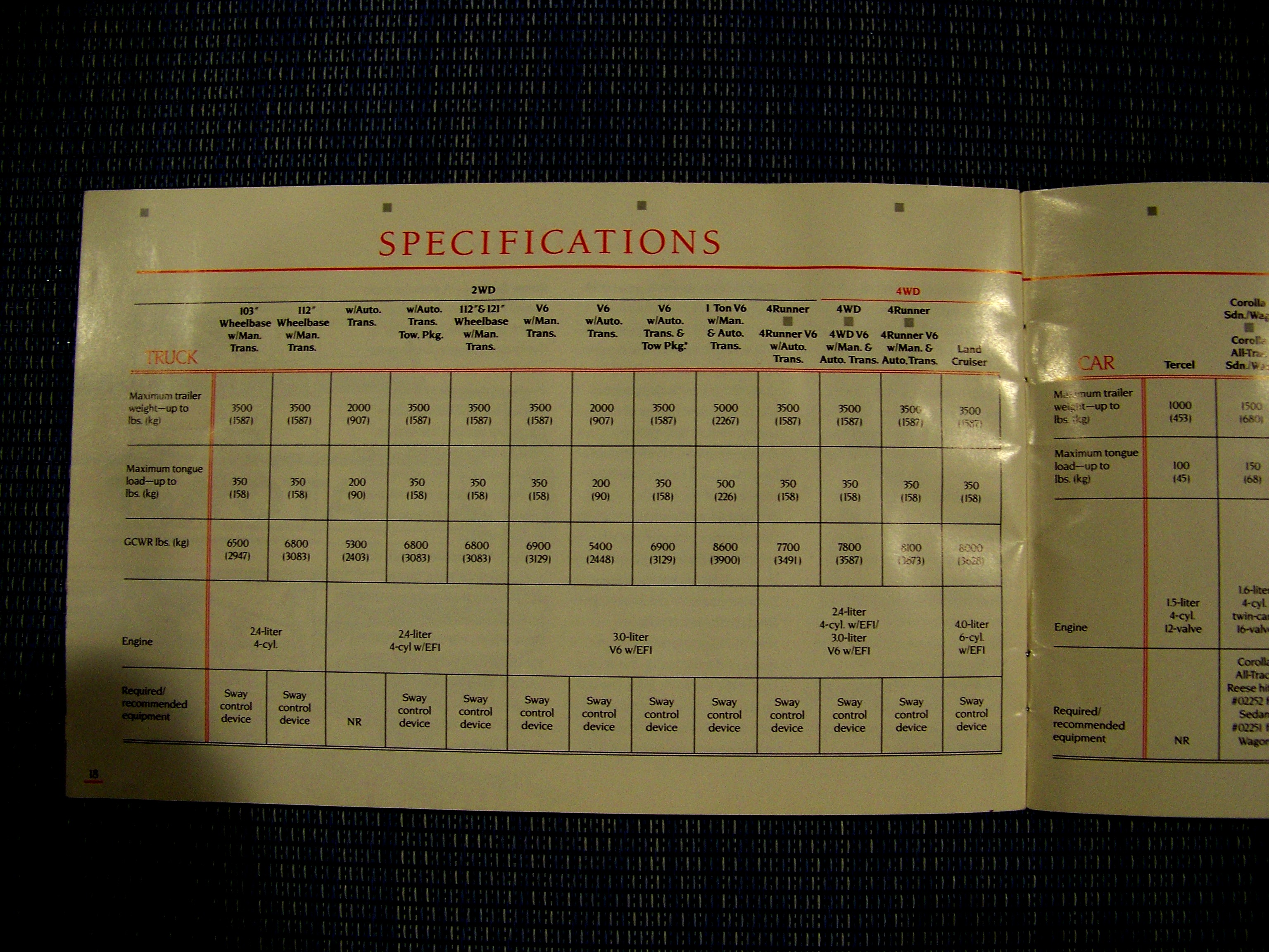

for 1990 sales brochure
see bottom left.

Yes, the brochure is for trucks only.
don't have one for 4runners. Trucks should be close though. My post above was for 2wd trucks. 4wd trucks don't list a tow package, and refers to the towing guide.
Below are the towing guide specs including 4runner for 1990
