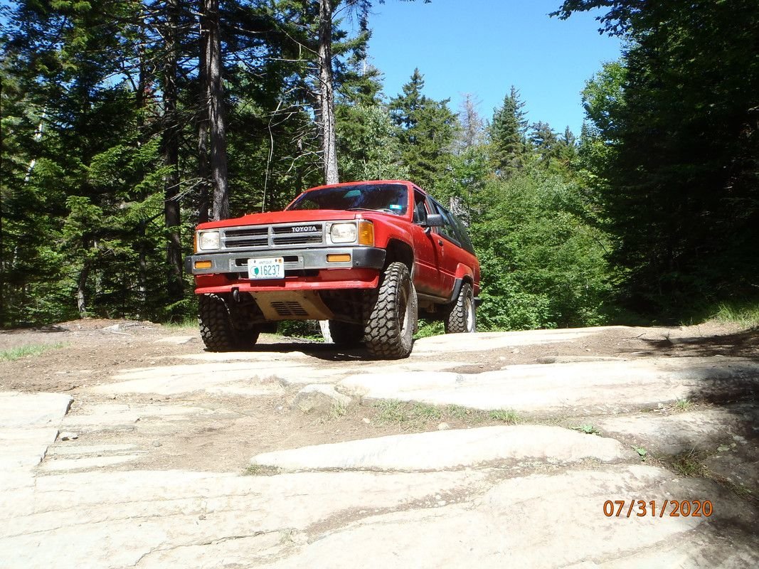

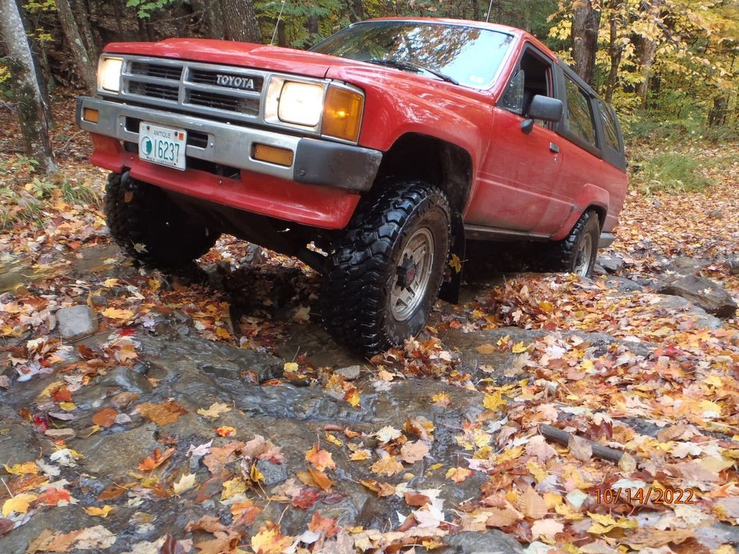

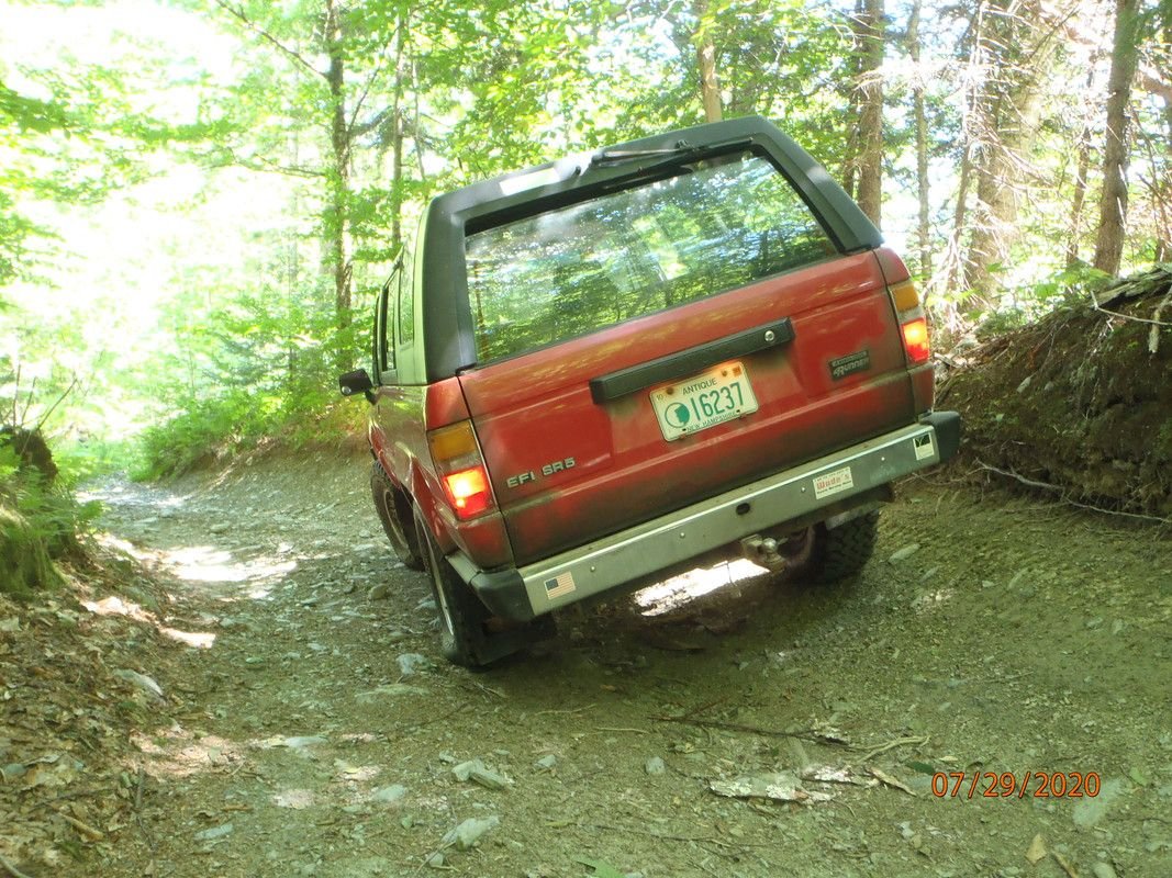

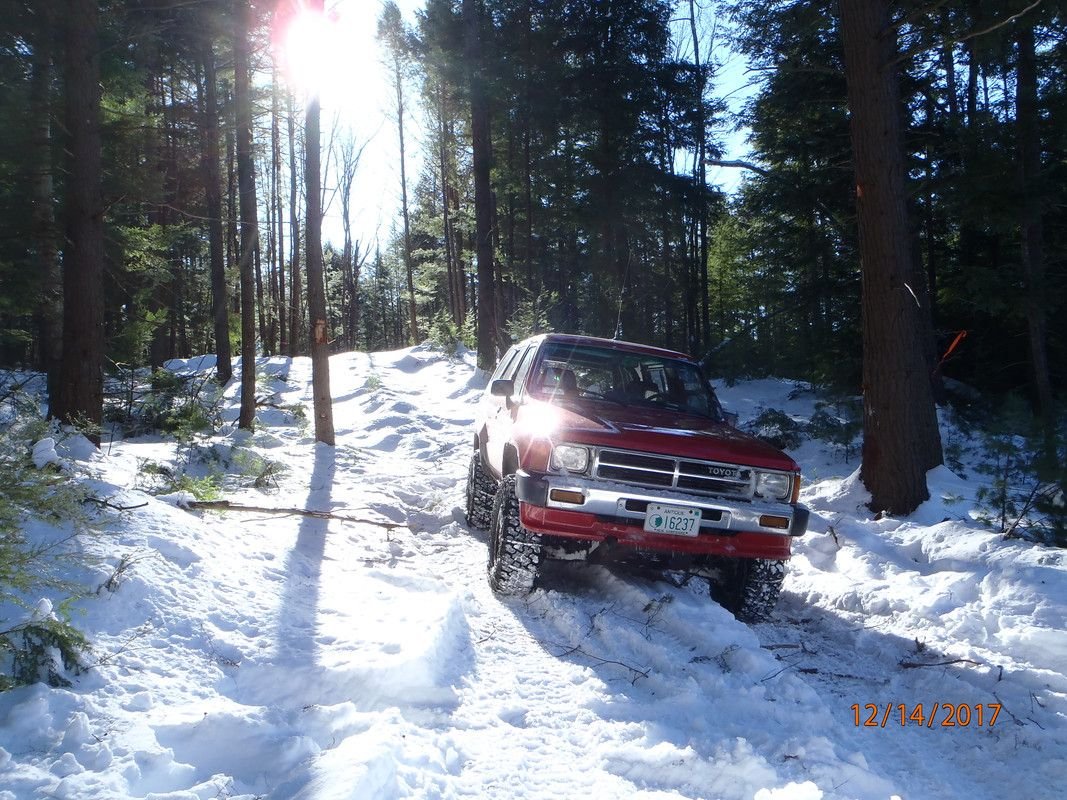

NWOR makes torsion bars still. These may still be stiff if you dont plan on adding a winch/bumper. https://www.northwestoffroad.com/parts/torsionbars.php
Other companies like OME and swayaway used to make them too, but not sure if they still do. Not much aftermarket support here for small lifts anymore, most companies are focusing on Tacoma's these days.
the BJ spacers are probably your best bet for small lift, besides just cranking up the bars.
You may be able to adjust the keys to get rid of the lean.

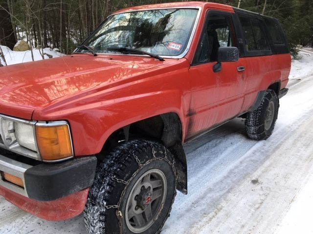

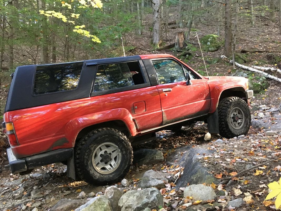

i guess it all depends on why you want a lift. almost any modification you make to the suspension will sacrifice some aspect of ride quality. BJ spacers do, and create added stress to the front end components.
i am able to fit 32x11.5/15 tires on my 1st gen running completely stock suspension. no rubbing on the street; no rubbing when wheeling it.
