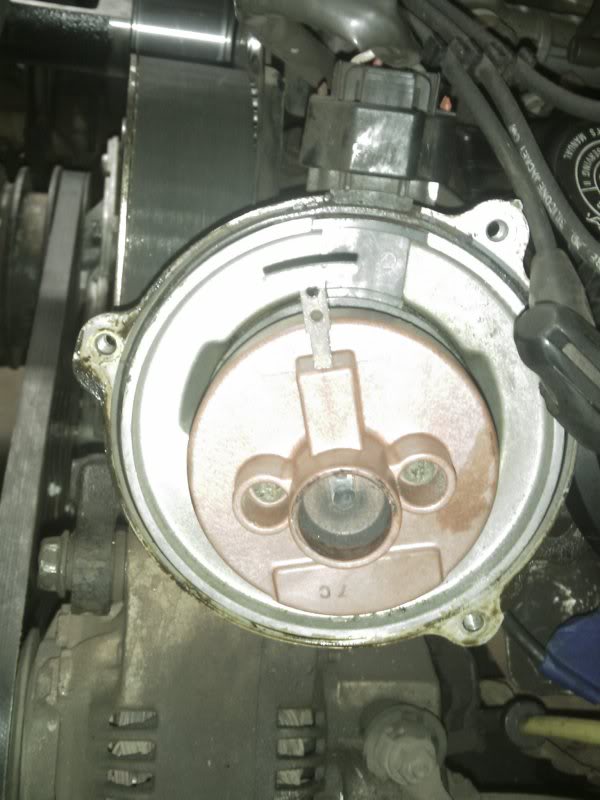

Set crank at TDC and removed the distributor cap. The rotor isn't pointing straight up, it's about 15 degrees to the left. My guess is that this is why it won't start.
So my next question is how do I turn the rotor? Remove it and re-install, or is there another method to turning it back so it points directly at #1

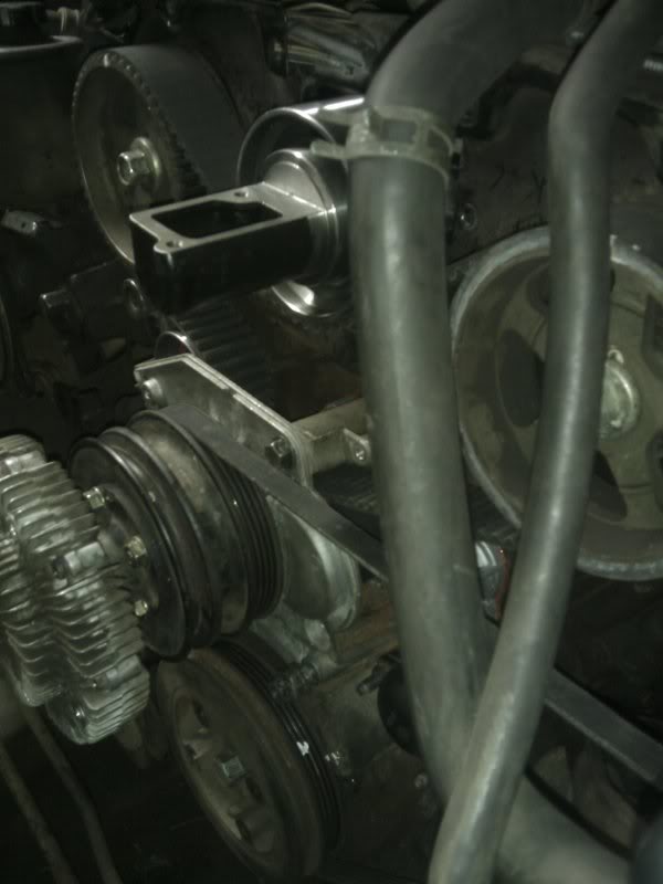

Here's a couple pictures taken with my phone:

Remove and reinstall. The driven gear is in the wrong position. Should look like this:
https://www.yotatech.com/attachments...tdc-small-.jpg

Thanks betelnut and buckz6319. I'll check to see if I have that stamped #1 but I don't remember seeing anything like that. Though it looks like my rotor's actually in time according to buckz6319's pic. If that's the case, anyone have any other ideas why it wont run?

If you get to the point where you think the timing is ok and it still wont start and you've been trying to start it a bunch, it might be a good idea to remove and clean the spark plugs. Also, check your wires and plugs to make sure they're ok. I had a similar problem recently and it turned out that one of the plugs was literally broken.
Maybe its the photo but the top photo looks to me like the white dot is off to the left a bit but it could just be the camera angle.
Did you line up the white dots on the top and put the bottom line at zero degrees? I believe it should be at zero and not 10.
