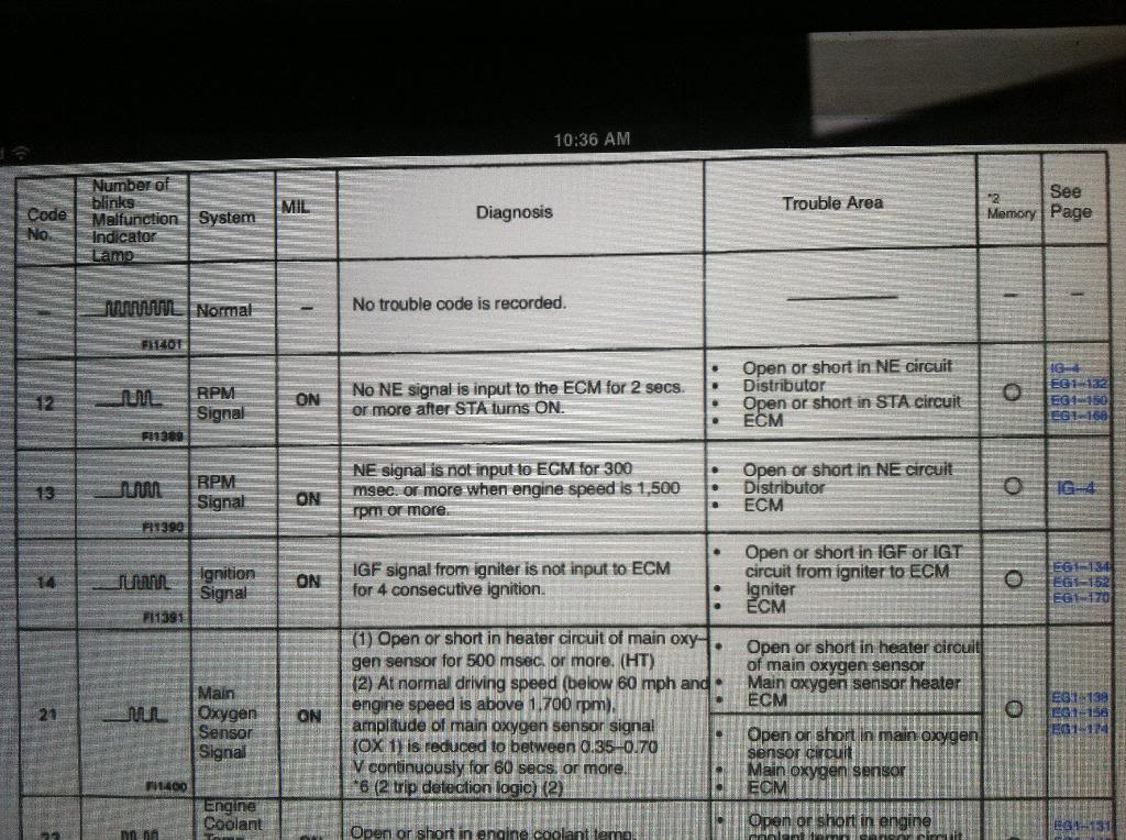

Here is the code for a 93 22re from the FSM. I would go over all the electrical connections and make sure they are all tight. I think there are only 2 that run from the main harness bundle. One goes to the afm and the other goes to the ignition. Then there is the small wire that attaches to the distributor. Look for kinks in the wires. Good luck. Hope the helps
