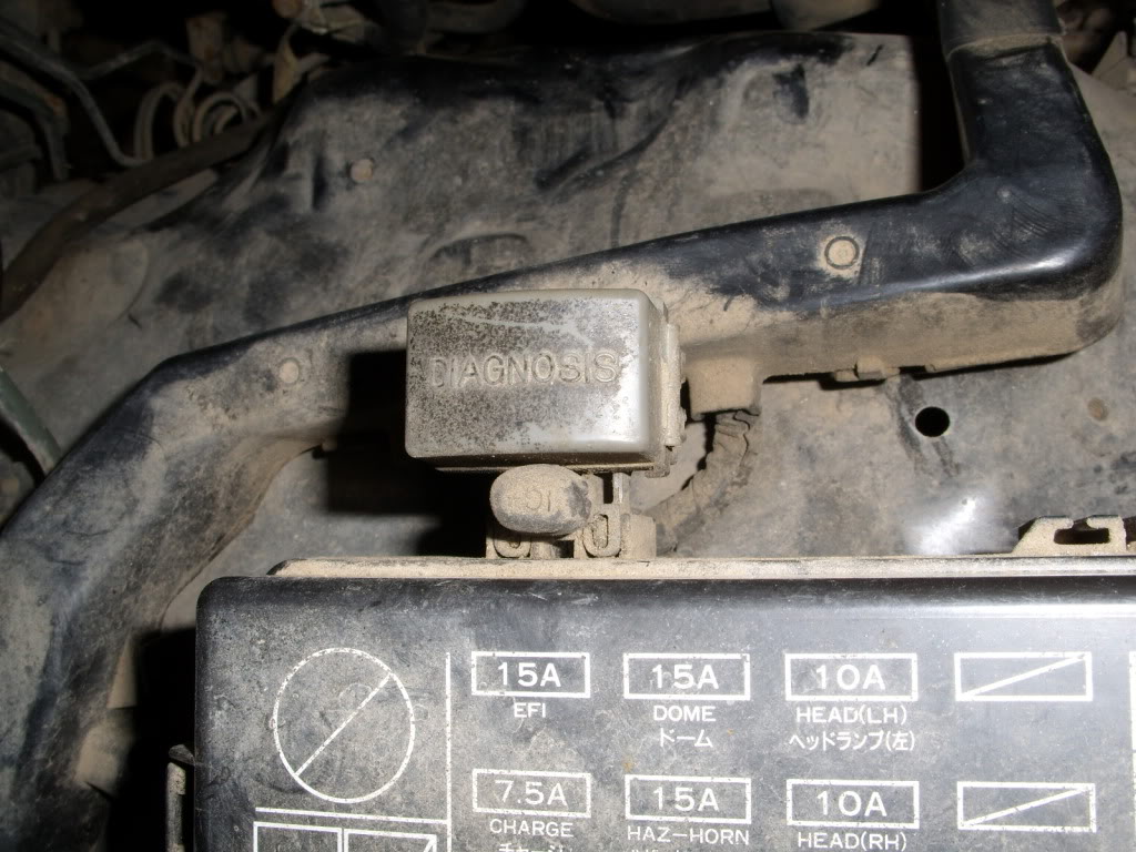

Here is the diagnosis connector with the cover still on:

Here are the connections to jump:
