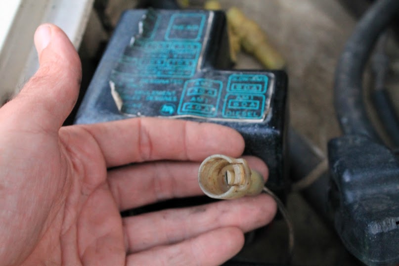

p.s. Any idea what those yellow plugs may belong to?
Are those diagnostic connectors? http://www.4crawler.com/4x4/CheapTri...CheckConnector
