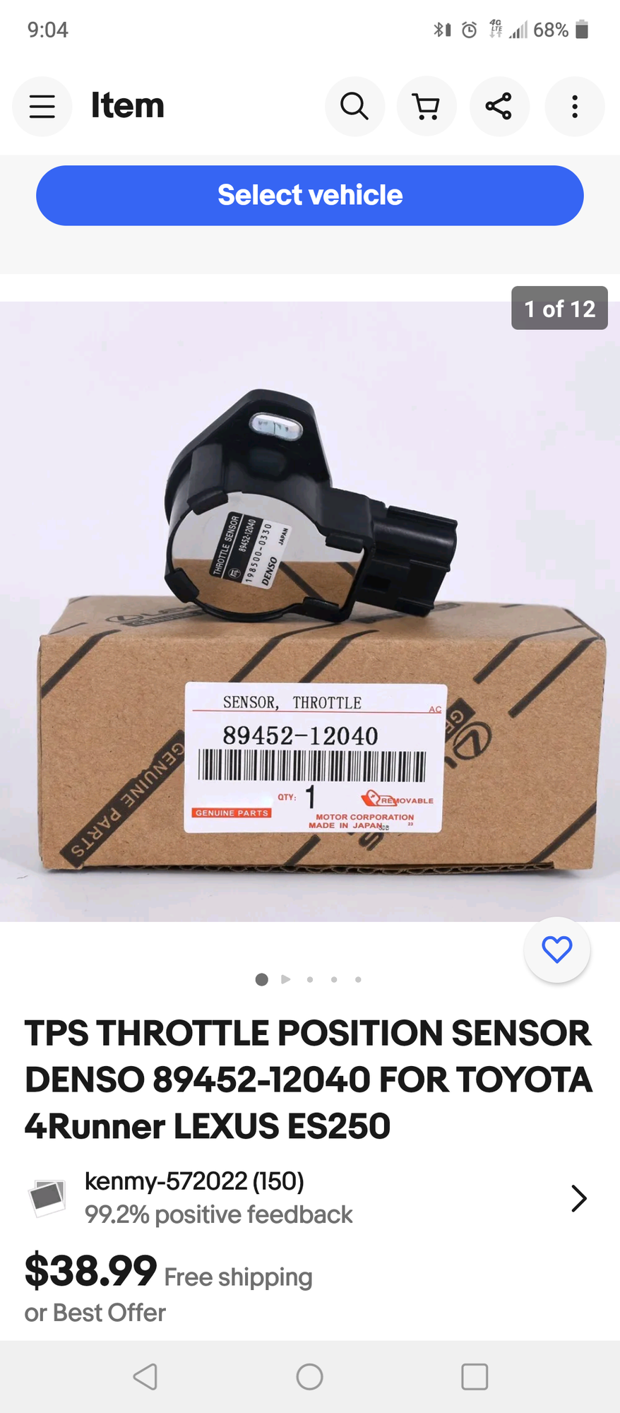

Throttle Position Sensor
Found this on eBay. The price is roughly $100 less than places like LC Engineering
and Yota shop are selling them for. Anyone tried these and are the ligit?

I wouldn't buy a TPS on ebay. To many counterfeit parts out there. That is about the most important sensor on the engine.

That's what l'm thinking. Specially for that price.
Problem l am having is l set up my current TPS after taking the TB off and cleaning. All the readings were within spec. And the IDL is working properly. Then l checked all the values from the ECM end of the plug. All readings check OK. Plugged it toget her and backprobed and the is no reading when checking pin 1 and pin 3. So pretty sure it's a bad TPS. But not 100% sure, so plunking down $150 bucks could hurt.

Here it is for $91. (Assuming correct part#) https://toyotaparts.ourismantoyotaof...IFJlc3VsdHM%3D
Toyotapartsdeal has it for $96, dont know who comes out ahead with shipping. Both reliable toyota dealers.
My thought is, buy from a reliable source and you will know what you have is authentic and works. You will never need another one. Good luck
